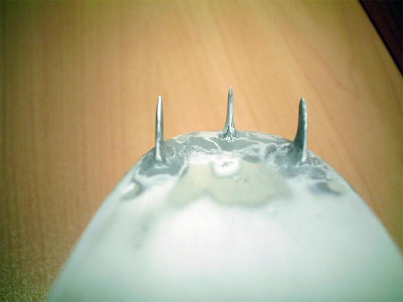

After sanding, and more sanding it was time to start work on the fins. I made shapes the same way I did for the board, using FCS fins (the ones Kelly uses). These are small and not easy to work with, but I only needed a fairly correct shape, apply filler and shape it back to a more accurate shape.
I added a fine coat of primer, filled in some more and sanded even more, then marked up where the fins should go, and used a dremel to make grooves to fit the countersunk fins (the need to be strong and not break later on)
I used an epoxy to secure the fins. Then after curing, I used filler to make a body for the fins, that later will be sanded down a bit.
