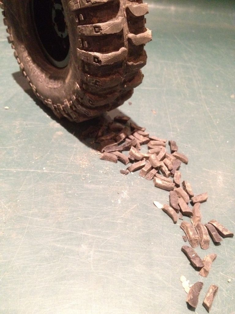

I have done some short testing on these tires and they are nite and day compared to stock.. and dont a LOT of the guys that run these on their 1:1 rigs cut'em up as well?? I tend to see a lot of them modded.
so heres what I did to mine and they work good now for hard dirt/mud with roots hill climbs. and i have the pumpkin clearance i want vs. the TSL sx.
tell me what you think..as far as how they LOOK. i think they look pretty good cut up!!"thumbsup"
and i still plan to just remove every other small lug from both sides around the whole tire...then... maybe even more siping!
pretty much just cut the small lugs at an angle towards the center, they are cut in half almost, then siping then at an angle as well.. this helps the tire not fold over while turning and great for side hilling! also put deeper crosses in the side tread.
Looks good "thumbsup" I have seen them with the whole lug cut out before but not the way you did it! Have you done a test yet in dirt and or mud to see how they perform? If so please post an update!
That looks sweet I just ordered some and I was going to cut all the small lugs but now I'm copying yours

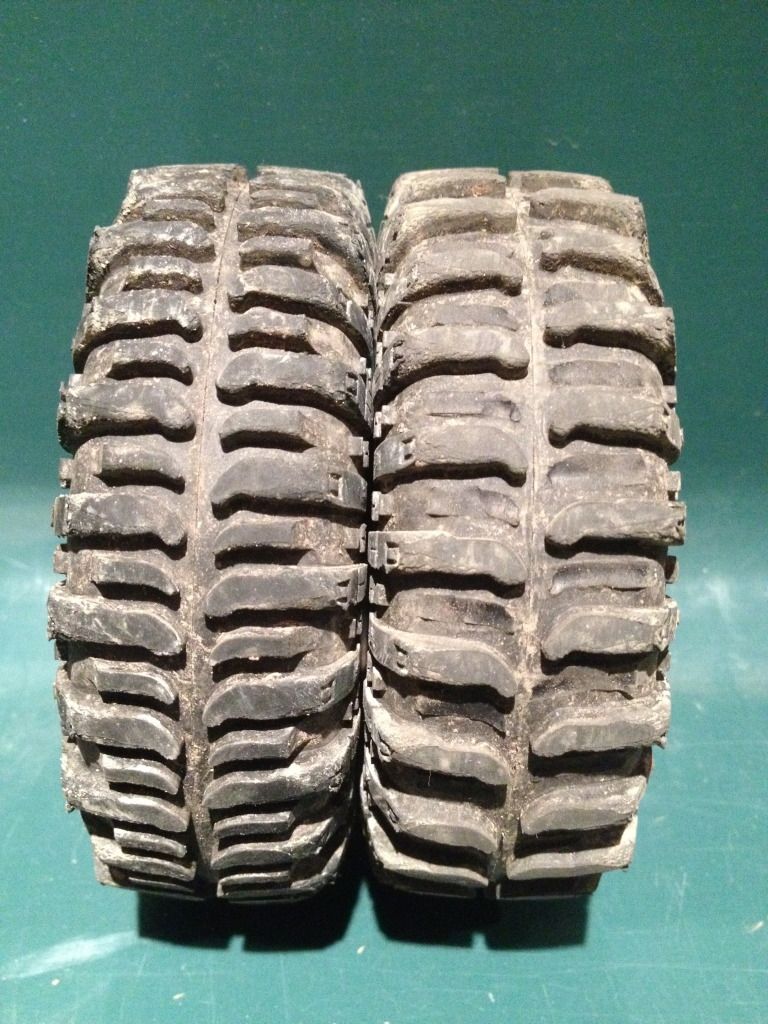

My artsy shot...
One beside the other, siping to come
So far I've just used Lexan scissors. You have to bend the heck out of the tire to get a good cut.

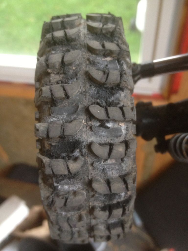

I was holding off posting cause I wanted to sipe them, finally did using lexan scissors. Problem is they just make thin cuts and don't take any material out.
I was waiting to buy a diamond cutoff wheel for the Dremmel but they're over $30, so in despiration (and on the advise from a fellow Canadian on durhamrc.com) I tried a crappy cheap-o cutoff wheel. It seems to work ok, I've only done a few test sipes. Not the prettiest but maybe if I has used the wheel before I had cut the sipes it would cut better.
This is the flex I'm getting on rocks now:
They ain't no Pitties but much better than before the lugs were cut out.

They look better without the rubber dust on em. And do this outside, basically burning rubber blowing in yer face. That's fine if you're an ex-drag racer, but not everyone gets a flashback to 80 cars drag racing on hwy 400at 3 am when the rubber smoke hits the nasal cavities."thumbsup"
They work MUCH better than stock. The sidewall softens up, the siping grips rock better and with the small lugs gone, cuts through mud pretty good. And I was happy......
