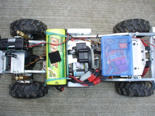

Here's my Flatbed Hybrid Yota...
Specs:
Bruiser Chassis
TLT Axles w/ Fatrock C's & Aluminum knuckles (front) MSD Lock-outs (rear)
Pede Tranny
Custom Skidplate based on "Chino bruiser skidplate"
OG Bruiser Cab & interior
Custom Bumper & Flatbed
Cut & Shut 1.9 M2K Tires on HPI Stock Wheels
4-linked (Rear) & Bruiser Leafs (Front)
Novak Super Rooster ESC, Integy 55t Motor, Spektrum Radio
Custom Headlight & Tail-light

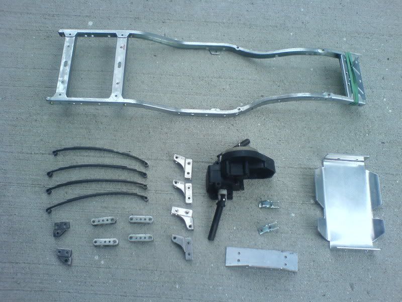

(I started with this http://www.rccrawler.com/forum/showthread.php?t=86394 , but decided to go with 1.9 )
The parts i started with...

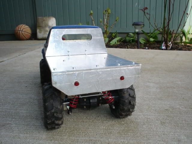

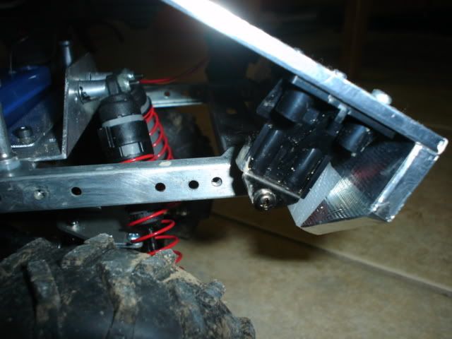

How I mounted the bed for easy access...
Front View
Rear View
Side View
great job on the rig. liking that flat bed man! trying to fit my interior on my hilux build with the stampede tranny. how much clearance do you have between the interior and tranny?
about 5mm clearance from the spur gear support (dont know the right term for it) but if you shave the extra plastics on the pede tranny, you could get a lot more clearance for your interior.
