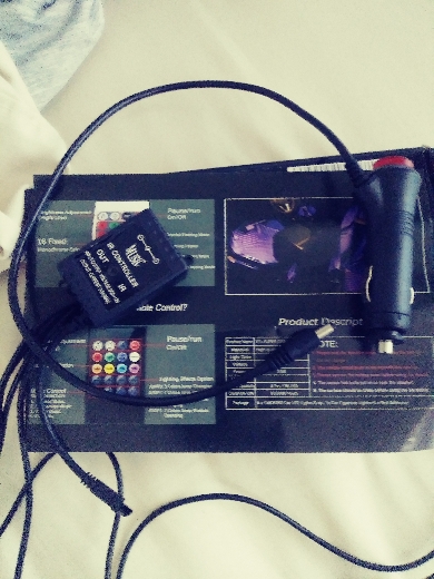

Hey crew long time no post(lol) So i bought a little light system for my car,question is instead of using the cig lighter to run it,can i use an off/on switch and a lipo to run those 12v lights?
Can i buy a on/off switch and use my lipo to run the light system?
I know it's possible,just to much to plug into the cig lighter....lol
Would just like an on/off switch and a lipo battery.
Thanks again crew.

What's up my Mr. HumboldtEF,how's it going? Its a car interior led strip set.
Multicolor.
I'm asking about converting it cuz my Cig lighter kinda shady...lol
What I'm thinking a small mah 3cell,its not like imma run it for hours. Plus just for some reason lipo seems right for this. Less wires per say???
