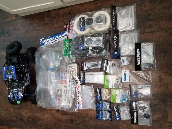

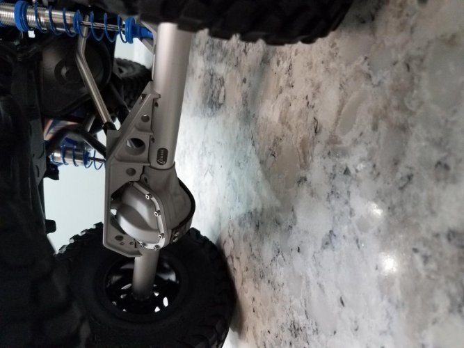

Figured the pic posting out ��. Picked this all up from rpp yesterday and when I got home from work I packed for my trip today and got the rear axle built and the rear links on. 1 Week of my daighter racing bmx world championship and I can get back to this ��

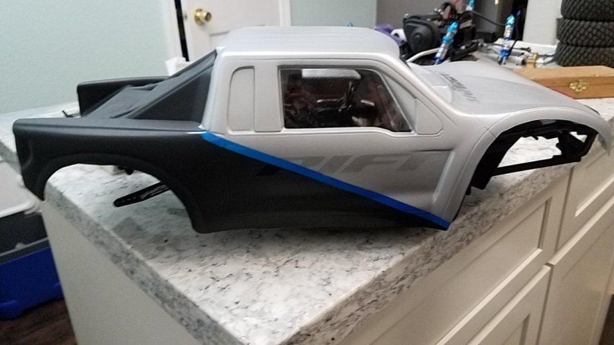

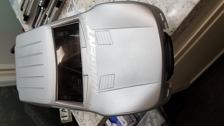

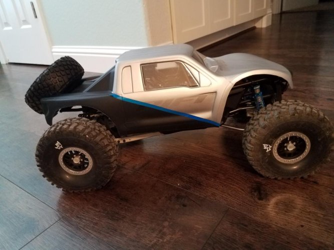

Got frustrated with esc so I paintrd and mounted the raptor body. Flat exterior with some ghosted bmx sponsors of mine and seperation stripe with normal shine from lexan

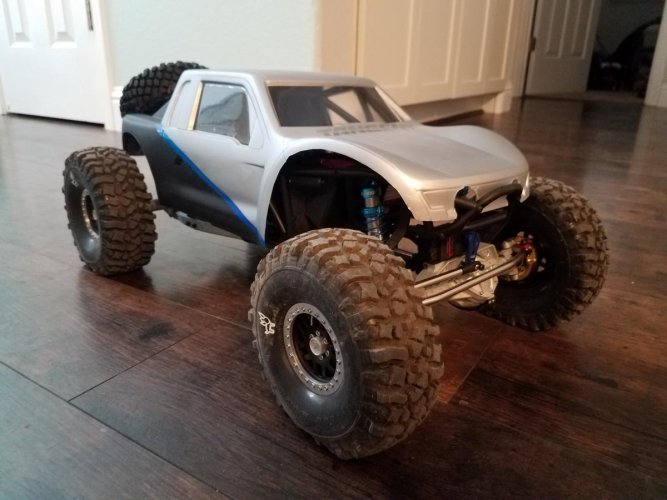

Got to run the bomber some and so far everything is good. I think I need some longer rear top link rod ends to better the drive shaft alignment
