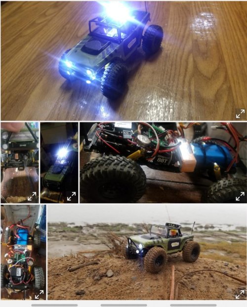

You can fit it, esc should have no problem powering up the crawler. I am able to fit and use a 2S 1500 pack aswell as a 3S in my deadbolt chassis.
