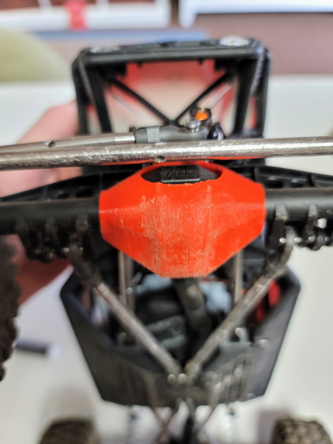

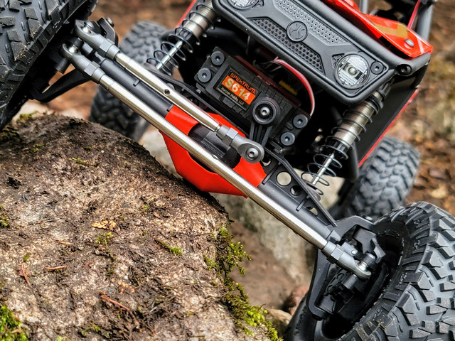

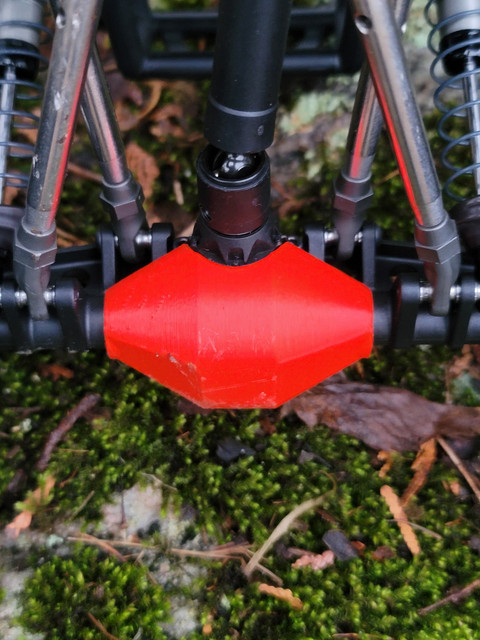

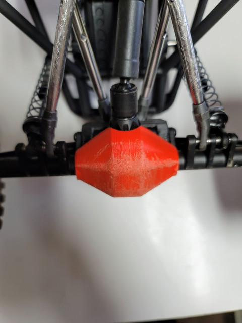

I wanted to protect the diffs but didn't want anything that left any edges to get hung up on things. I couldn't find anything so I ended up drawing some up and printing them out. They are only 1.5mm thick so there is only a minimal loss of clearance. The front guard is notched for steering linkage clearance.. They do not require any hardware since they snap in place. I abused them for 30 minutes today and they are holding up great.
Let me know what you think.
Honestly, I've never been one to worry about draggin the diffs, but those look pretty darn slick. Nice design and execution with, as you stated, minimal loss of clearance. Fitment looks superb. I assume they just kind of snap on / around? Also, for those just trying to get a splash of color, aesthetic, they might be nice printed in any multitude of colors.
Nice work! I'm not a fan of diff guards but you just broke the mold
What material did you print those out of?

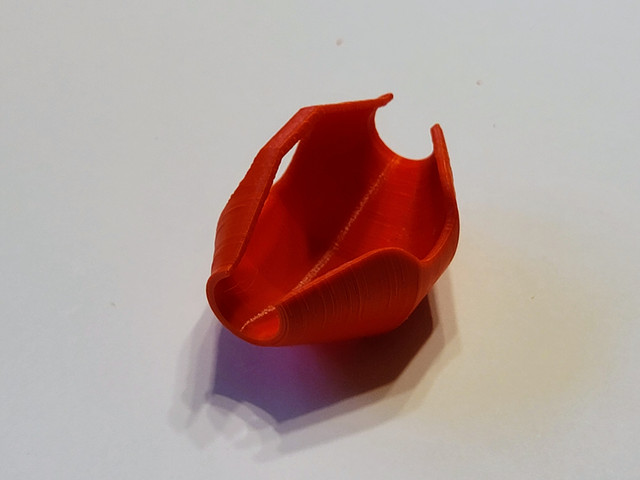

Thanks, they just snap on around the diff, they're not real easy to remove so they won't come off driving. Here's a pic of how they look not installed and a pic of a black front guard.
I'm printing them in Esun PLA+ which is 10x stronger than regular PLA. The orange set has taken about 1.5 hours of punishment in 25 degree Fahrenheit weather and is holding up fine.

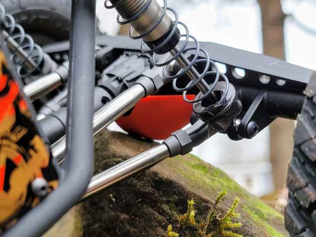

The front edge of the rear diff can get stuck on sharp edges, these keep that from happening. When they're printed in black they are less noticeable, I printed my test set in orange since that was in the printer at the time. I'm not too concerned with the scale look, with the diffs being centered it doesn't look right anyway.
