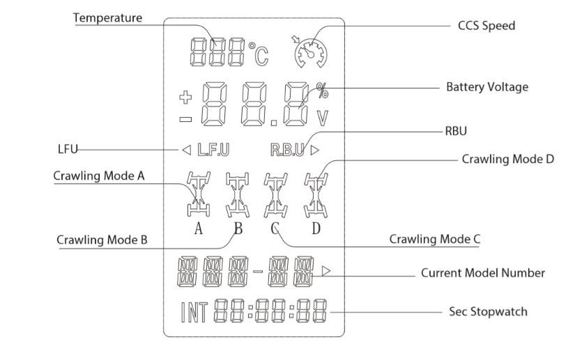

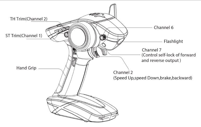

Hi,
quite a lot of new car transmitter brands show up on the market, Hobby Porter now after Dumbo RC some days ago.
Anyway, interesting, 50 bucks for 7-ch, rx, gyro, crawler mode, display:
Hobby Porter HP007
763769-hp-s1-jpg
763768-hp-s2-jpg
763770-hp-s3-jpg
Link to manual (PDF): https://www.hobbyporter.com/u_file/1904/file/e55eba0bdf.pdf

Kinda gimmicky, but i'll admit the flashlight feature COULD be useful in some situations...
Looks like a GT5 wannabe LOL
Sent from my Pixel 2 using Tapatalk
Not really. This looks as much like a GT5 as it does a Kyosho Syncro.
Don't we all carry smart phones with flashlights these days?
I think it's an odd feature to have in a radio. Not a bad feature, but odd and, as you say, gimmicky. But if it's an LED so it should last a long time.

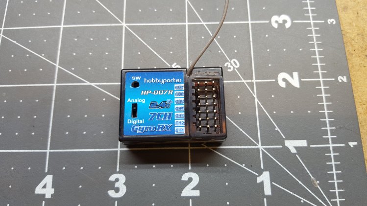

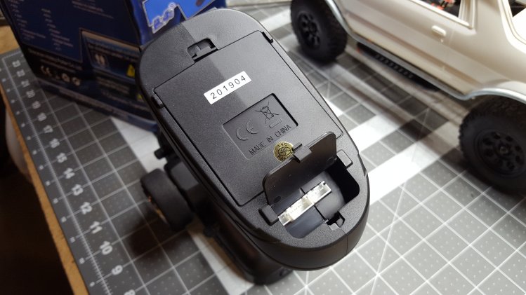

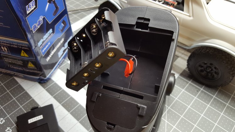

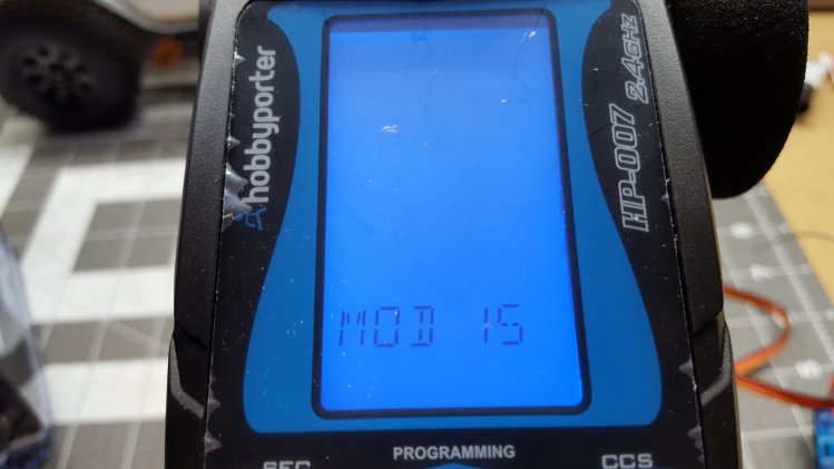

Mine showed up today and I will say I think the features will definitely be worth the $50. The tx feels cheap but no less than my flysky gt3c which has survived a long time.
It looks like it is set up to run a Lipo pack if you want and it does have the plugs to check Lipo charge on the bottom of the tx.
I installed a servo on each of the 7 channels to see how they are set up.
1 - steering
2 - throttle (funny thing is the top of the tx lights up when you move the throttle)
3 - momentary switch (moves when you hold the button in then returns to original position when you release)
4 - 3 position switch
5 & 6 - linear dials
7 - 2 position switch
Now for a couple videos and pics.
