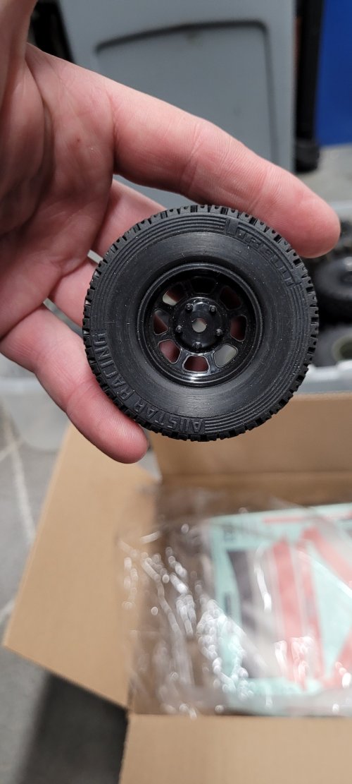

This picture does highlight probably the biggest limitation with using a drift body on a trail truck. Tire clearance. So I went tire and wheel shopping on Ebay and found some 78mm diameter tires on 1.55" rims. And then in a fit of indecision bought both appropriate sets of tires and 2 other sets of wheels and tires.
Top Left wheel and tire ended up going on the 510 for now. Kind of a BFG Krawler rip-off tread but the upper right reminds me more of an era appropriate tire and also a BFG rip-off. Bottom 2 tires are 3.75" OD BFG KM3 rip-offs. Pretty sure there is no licensing to use that name on the sidewall. Lower left set ended up on my newly built Tamiya BBX.

The traxxas 1.9 stock car wheels with the lettering removed look pretty good as a stock steelies with a huge sidewall. This is them on some 1.9 hpi pirelli rally tiresView attachment 509525
Those do look good and I like the Pirelli branding. They'd be era appropriate for sure.
BUT, the wheels I'm using in all the photos above are all 1.55" and the smaller tires have an OD of 76-78mm. Anything bigger will just cause more body/fender rub and I'm trying not to just cut out the fender all together. Trying to preserve some of the road going look.
I also really dislike tire rub so it's going to be a balancing act.

I did actually get the bolt on fender flares from Pandora but just don't really like the look of them, plus when I was considering using them it was just adding too much complexity at the moment. Still a bunch of stuff I need to figure out.
For full-on vintage BRE Datsun racing wheels, search for HPI MX60 4-spoke American Racing wheels, available in 2 offsets and Matte chrome, black, gunmetal, white (and maybe more?)...
There's also the old-school Mini-lite (aka Panasport) 8-spoke HPI wheels, Proline makes basically the same ones.
You could try stretching 1.55 tires over the plastic wheels,, too.
