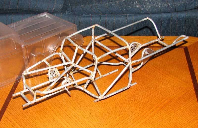

With Axial's B-17 body release I just had to do it. After seeing all the tube work being done here I had to try my hand at doing that too. My first attempt ended being more of an unlimited desert buggy. I'm still trying to figure that one out. Must be the way I plan these things out or rather NOT planning these things out. So I threw that on the shelf and I plan to park my Dakota on it just to see how tough it really is. It holds my weight no problem.
Anyhoo, The rough sketch calls for TLT axles, Pede trans and some Dirt Hawgs I have laying around and a cutting board chassis plate. The suspension and trans mount to the board and the chassis mounts to it. I learned that on my buggy. Talk about building a ship in bottle. The tube work is built to the body but the way it's turning out I may not run body half the time. It's only my second attempt at a chassis but I like it naked. I like my first one too but it just too top heavy on narrow TLT axles
First day's work
Next day in mock up
The I got around to bed rails but I've stop there. I'm not sure which direction to go.

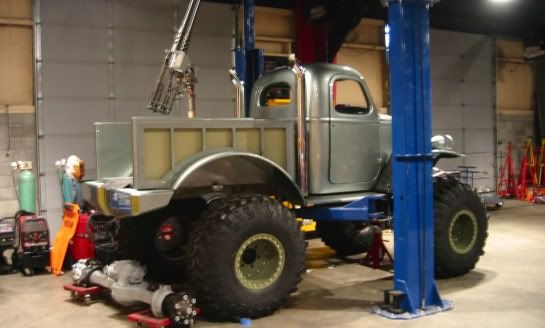

nice looking truck so far. i thought you were going to a scale version of sgt. rock from "trucks"
I knew that eventually someone would do this. I've been wanting to, but with some TXT/Jugg axles and leaf springs. "Sgt. Rock" is one of the baddest trucks i ever saw, what I'd call a monster truck for the street. (or anywhere else you might want to go) Yours looks great. Personally, I would cut out the bed and maybe make a styrene inner bed? But I like the idea of just cuttin ghte bed out and adding some rollcage braces, too. More of a "monster truck/tuff truck" feel.
BTW, your tube chassis is just AWESOME! I wish I had the stuff to build things like that, I've been wanting a tube Monster-truck style chassis since forever ago.
me too, that truck was so bad @$$, too bad stacey left the show before he could finish it...
You can see more of it. He has a new show on one of the ESPNS called Gearz. He does more than just trucks now. One project is putting a 400HP Ford V-8 into a Miata.
BTW, The real Sgt. Rock has twin, fake 50mm Machine guns mounted in the bed on a turret now. And they fire...:twisted:

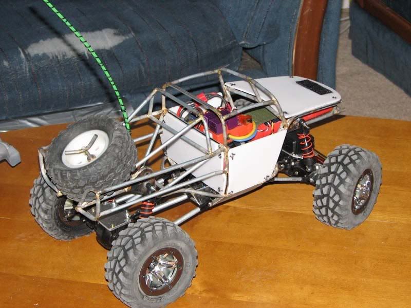

Mounted up the beadlocks for some runs to compare against the prolines. I had to drill some holes to get them to working the way I wanted.
I decided to make some body panels since I seem usually run with out the body. My wife came across some 1/8 inch cutting board so I used that for the panels. I'm planning on the chassis being black so I'm gonna try and use some automotive rattle can dye and match the panels.
