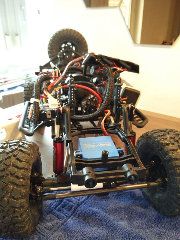

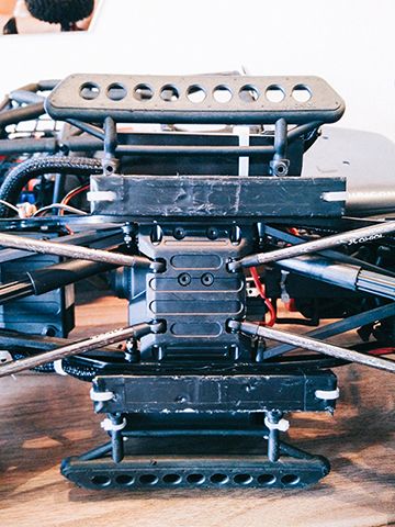

Front battery & rear radio box mod
You all know this mod and I quickly found out, why everybody does it :) It works and it improves crawling performance!
Simple steering mod (m3 nuts)
A guy I met at a local RC store told me about this mod: Add one M3 nut to both ends of your steering link (between your link and the ball end). It improves the stock steering performance significantly, although your tires point away from each other after this mod. Don’t forget to add an M3 nut to your servo link as well to account for the extended steering link!
Wiring & Plugs
When I saw the Tamiya plug on the Nvision battery, I was kinda upset. How can you sell a battery for this price and put a Tamiya plug on it? Now I’m happy that the battery had this plug because it made me rewire the whole build and it made me learn how to solder!
I removed most of the plugs I didn’t need, I removed the on-off-switch for the ESC and I added T-plugs to my battery and and ESC. So the Tamiya-sh*t-plug has it’s good sides as well.
Then I used some mesh tube to tidy everything up and keep the wires protected and organized.

I really like the JK’s stock shocks but I was looking for something more extravagant and scale… I was thinking about mods to separate spring and shock but I decided to go with internal spring shocks, which is the next best thing to me. I got the Boom Racing Boomerang Type I 100mm shocks and mounted them upside down. I think this looks great and it handles well on the trail. Included in the box are three different springs and I’m using the hard one in the back and the medium spring in the front. Additionally I just filled them with 30wt shock oil and I’m curious to find out how this affects handling.
Rock Slider Electronics Plate
I used some leftover polycarbonate from the body to create a plate that mounts onto the rock sliders to hold my ESC and the NVS in order to lower the CG.
Weight
I added some metal bars I found in my dad’s workshop as additional weight and it improved handling. My jeep weighs 8.4 lbs / 3.8 kgs ready for the trail.

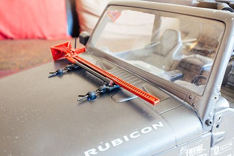

Hi-Lift Jack, Crowbar & Body Clips
I ordered the Boom Racing Scale Tool Set and it included a hi-lift jack and a crowbar. I used CA glue to glue them to my body pins et voila: I had a great mount and disguised my body clips :) (I’m gonna use magnets as a body mount on my next build)

A little update! The other day I got Level 3 RC's CMS Kit in the mailbox and of course I installed it immediately.
The kit is nice. The alloy parts seem sturdy and cnc'd well and it performs nicely. Thank god I got my Superlift steering damper earlier last week, so I had a steering link long enough to use with my CMS kit!
Installation is pretty straightforward. If you're on the three link setup though you have replace the stock spacer with the one that comes with the CMS kit. The isntruction are not really very self-explanatory here (the picture quality is just too bad).
However here are some pics.
Before:
After:
And some pics I took on the trail :)
