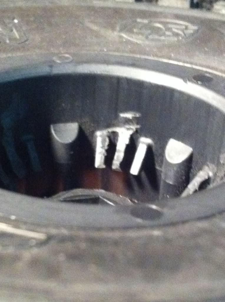

I run VP's wraith knuckles, which also have the relocated steering arm, and i was able to get them to clear the stock wheels by shaving down the slug retainers a bit. If you look, each slug hole on the stock wheel has 3 retaining ribs. the center of the three is taller than the outer two. This center rib needs to be made flush with the outer two, and it clears.
Here's a pic of a shaved down stock rim:
Thanks guys, this helps. I will see if I can find some of the knuckles and c-hubs for a decent deal out there and then just shave down the stock wheels.
I need some for my Wraith too so I guess I can just order two sets while I'm at it :)
I actually cheesed out and did it the super lazy way. I stuck the wheels on my Wraith that has a 4000kv brushless setup and goosed the throttle and the nubs were all knocked off lickedy split. :mrgreen:
