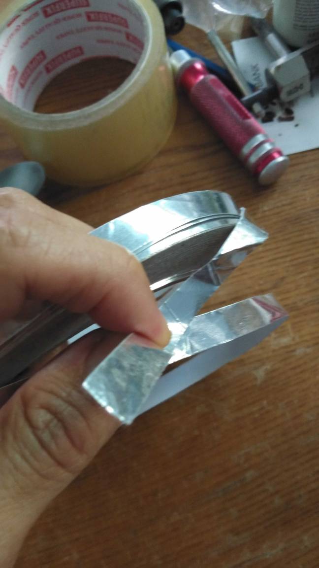

I used to put a K_type thermocouple on the motor to ensure the true accurate temperatures reading, thus I know how to fine tune my rig correctly. Thermocouple is so useful worth for trying. "thumbsup"
Hi, I just uses this special tape to stick the cable on the motor( Sorry but I don't know how to called it) This tape also used on my espresso machine to measure the brew group temperature. I hope this help. Cheers
Sent from my vivo 1723 using Tapatalk
Thanks tor the tip Teng. That's good to know.
