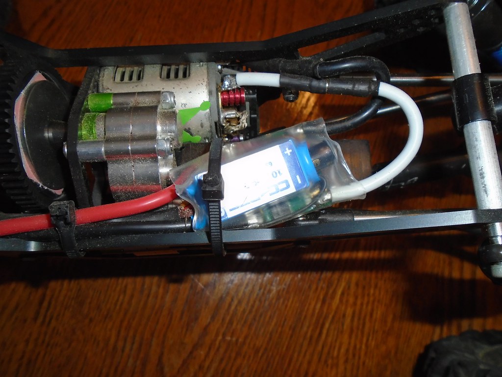

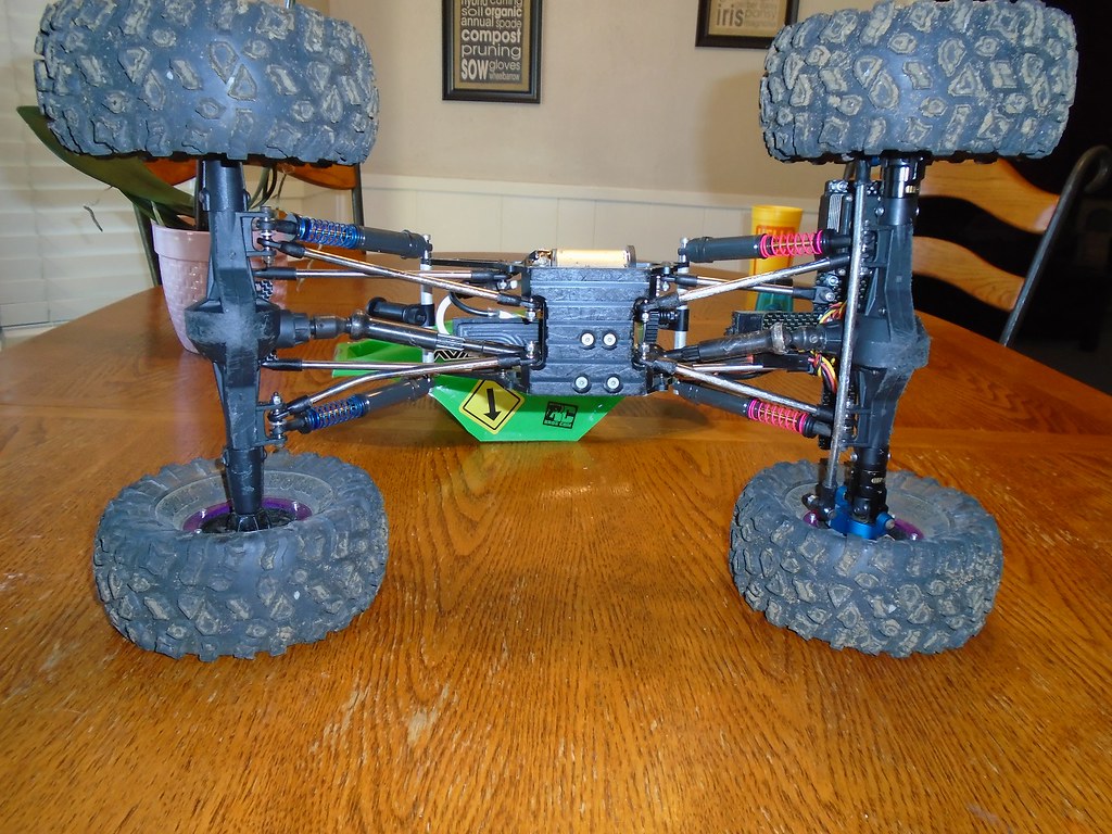

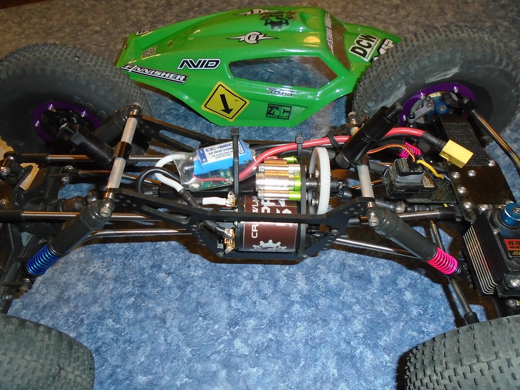

Here's some pictures. She works pretty damn well.
So, made a few upgrades today. New HH Crawlmaster Pro 16T Handwound, bent a solid steering link from 120mm titanium Rock Grinder, and upgraded the tars a little bit. Bully Comps with CI 5.25" Double Dueces. Having a very interesting problem that did not occur before the Holmes motor, or the tires. Did them both at the same time so it's hard to say which one.
When you hold it off the ground and give it throttle, it's almost like it is stuttering. Like something is binding up in the drivetrain because the motor does not stop spinning, nor does it have a problem spinning. Might be the OD/UD combo and drivetrain harmonics, or might be the tires. I'm not sure, but if anyone has any advice on that, that would be great.
Try compressing the suspension and running it. If the vibes go away you have three options tilt your front axle up, lower the front a bit, or increase the length of the front links.
my guess is the universal pins in the driveshafts
are not phased (aligned) correctly.
Each drive shaft should see the uni/cvd pins
of both the front and rear uni's in the same position.
Probably a good idea to phase both front and rear DS's
so the universal pins of each DS align in unison.
Thanks for the input, they are not aligned at all and also re-clocking the front axle was another priority.
I'll give this a shot and see where I get with it. Thanks!
Problem solved! Lined the driveshafts up and clocked the front a little further and no more issues! Thanks! Remarkably smooth now.
