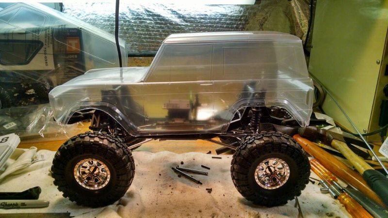

Test fitted body at ride height for the first time. Looks like I will need to shorten WB by another 8-10mm for it to be correct.
SHOme
WB set at 9.75in. New 1.55 wheels with Pitt Bulls. Thanks to Harry.
Sitting to high. I am going to track down some 100 mm shocks.
