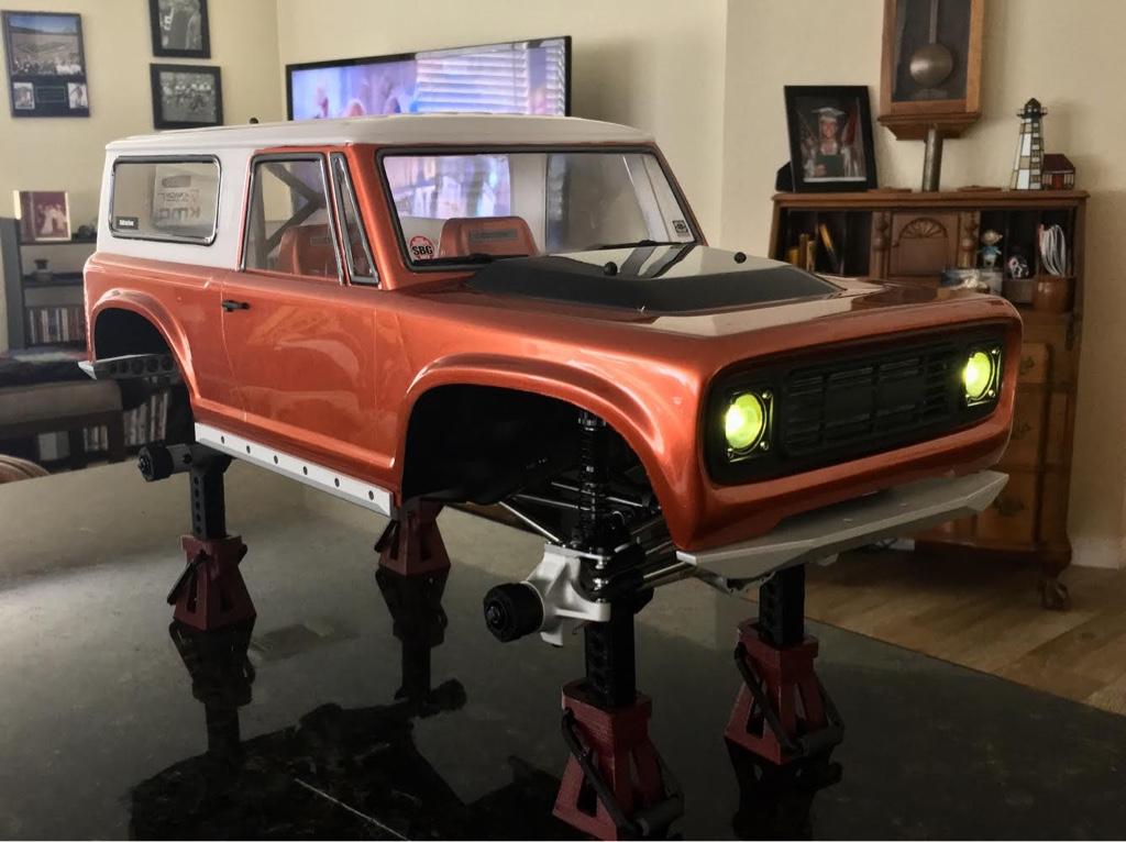

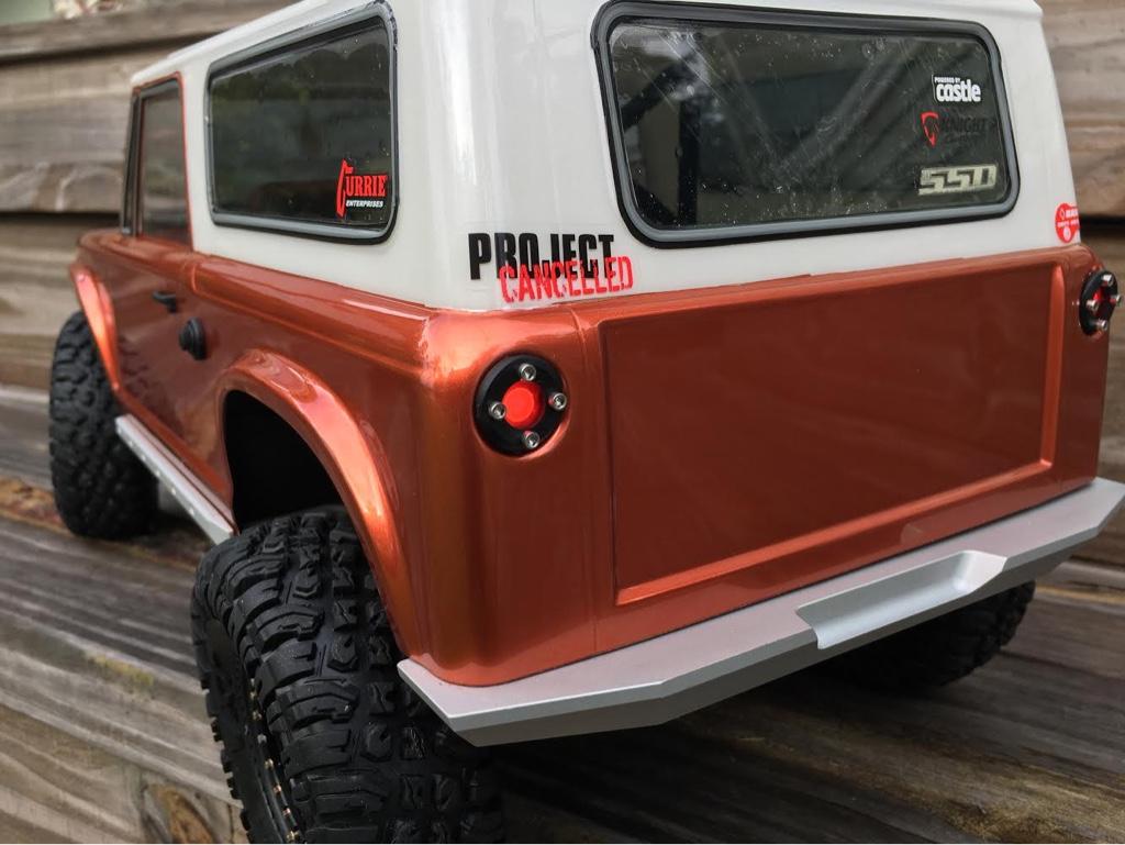

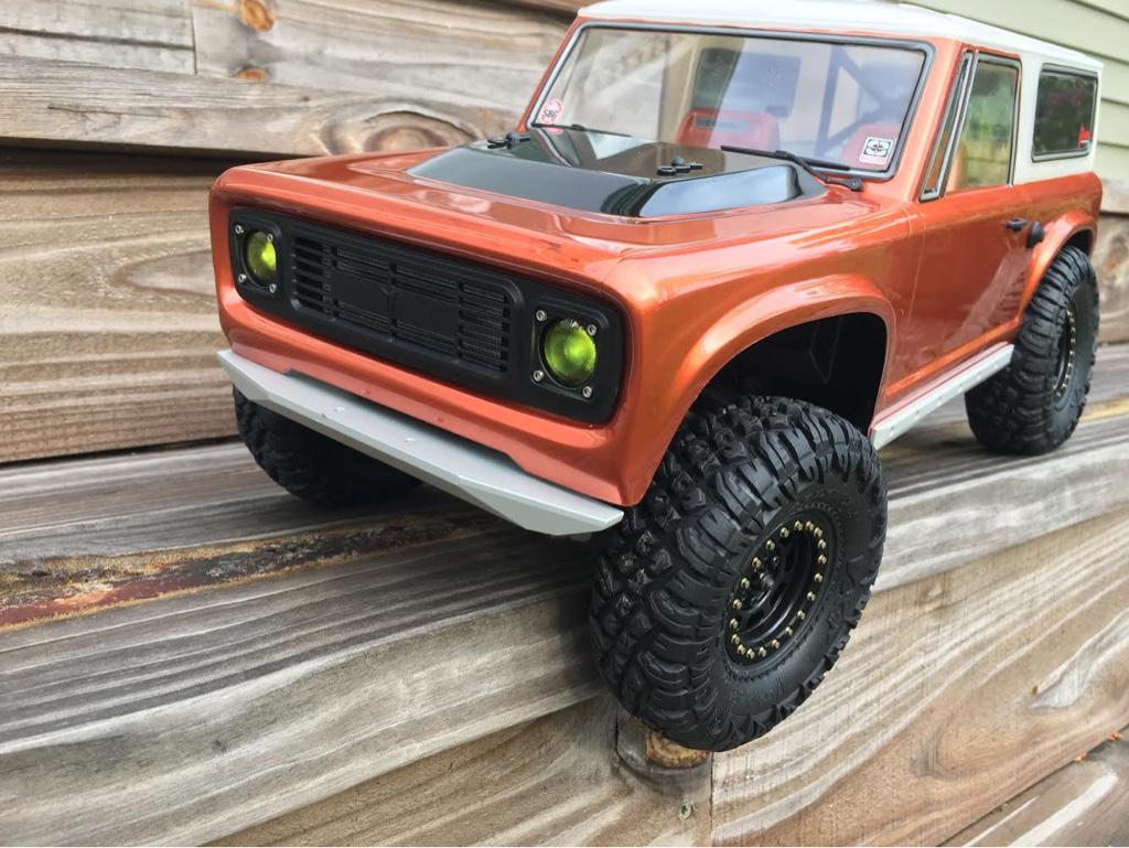

OK here you go. Auto tint on rear cab windows, Tamiya Transparent Yellow on the front lights. I used transparent yellow or mirror chrome in many buggies and SCT trucks. Any spray tint need a spotless clean surface, nice and warm ;both body and paint, proper distance for misting spray, 2 or 3 usually work well.

Thanks Mike! That rig looks great! Can't wait to get this new body for the Trx finished up!!! "thumbsup"

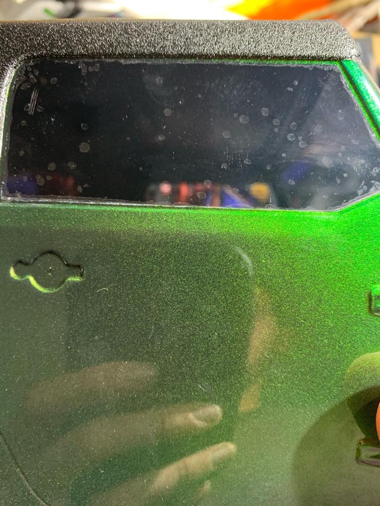

Well I got two windows done with the auto tint and I'm not having the best luck with it. They looked great when I finished putting them on. Then when I got home the next afternoon they were full of bubbles.
I don't think I'm going to go this route anymore. Too much work for them to end up looking like that. I'm going to attempt to remove the tint. Then I'll give the Tamiya smoke paint a try.
Add a drop or two of dish soap to a water bottle. Spray the service prior to applying the film. Lay the film on the surface you sprayed and squeegee out the air.
Totally..... then when using your squeegee, hot air will help. Laying it on a flat hard surface(table top) covered with a towel, you’ve got to squeeze all the soap water out.
