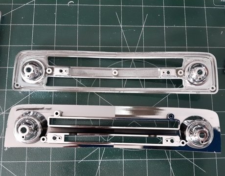

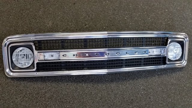

After countless hours of looking at pics and comparing the grills together (I have both grill sets), the Blazer and the C10 bodies have a flat grill area that gets cut out to allow for mounting. Although the grill cut out areas are different, I would just cut out the required area for the 69 grill, just enough so the mounting can take place. That way, if you decide later on to revert back to 67 grill, just more cutting will be needed to fit it with the simulated radiator bulkhead. Both grills are the same size, but do have slightly different head light positions, and the back panels are not interchangeable. I don't have C10 body yet, or I would have tried this already. I do have an awesome idea planned for the C10 though. ;-)
Here are a couple of shots of the grills...I cutout the fake grill inserts so I could add something a little more realistic. Hope this helps to get you going.

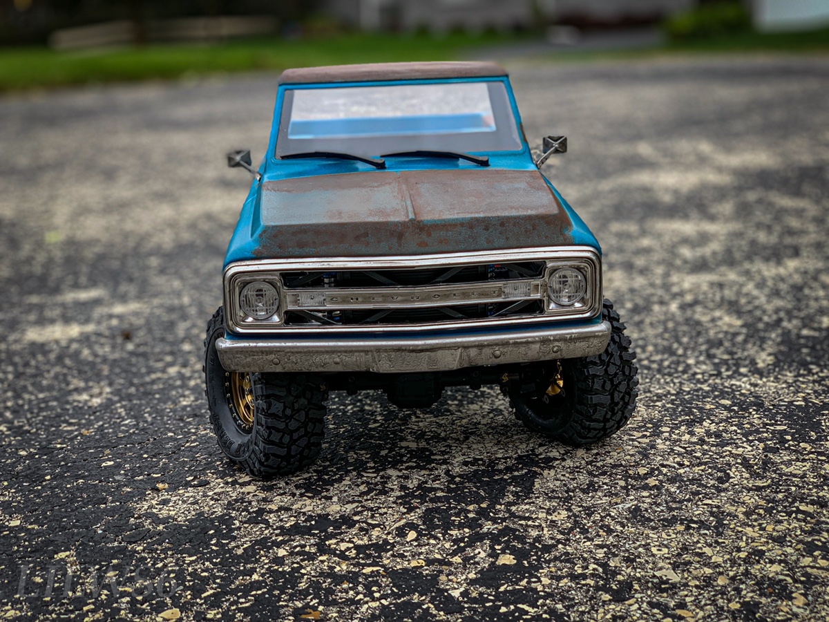

Thanks for those pics. That makes me think it’s easily do able. I did notice you can’t run the c10 radiator with the blazer grill since I could see the mounting screws are different. But now that I’ve seen the grills side by side. At least I know they are the same size and trimming the body to fit it nicely is all I need to do. That makes my decision to order the k5 grill that much easier. Thanks.
Th k5 grill will fit with just some minor adjustments. Nothing crazy. Just thought I’d post Incase anyone else had the same question.

I’m probably going to cut the outer braces and leave the inner ones. I made the c10 radiator bolt behind the grill so I’ll probably also make filler panels and I was thinking some mesh. Just need to find the right size...

That looks awesome and it's the way Proline should be doing things.
I think all the body makers should know by now we want a light lexan body with the proper accents to make it look right. Otherwise I prefer hard bodies normally.
