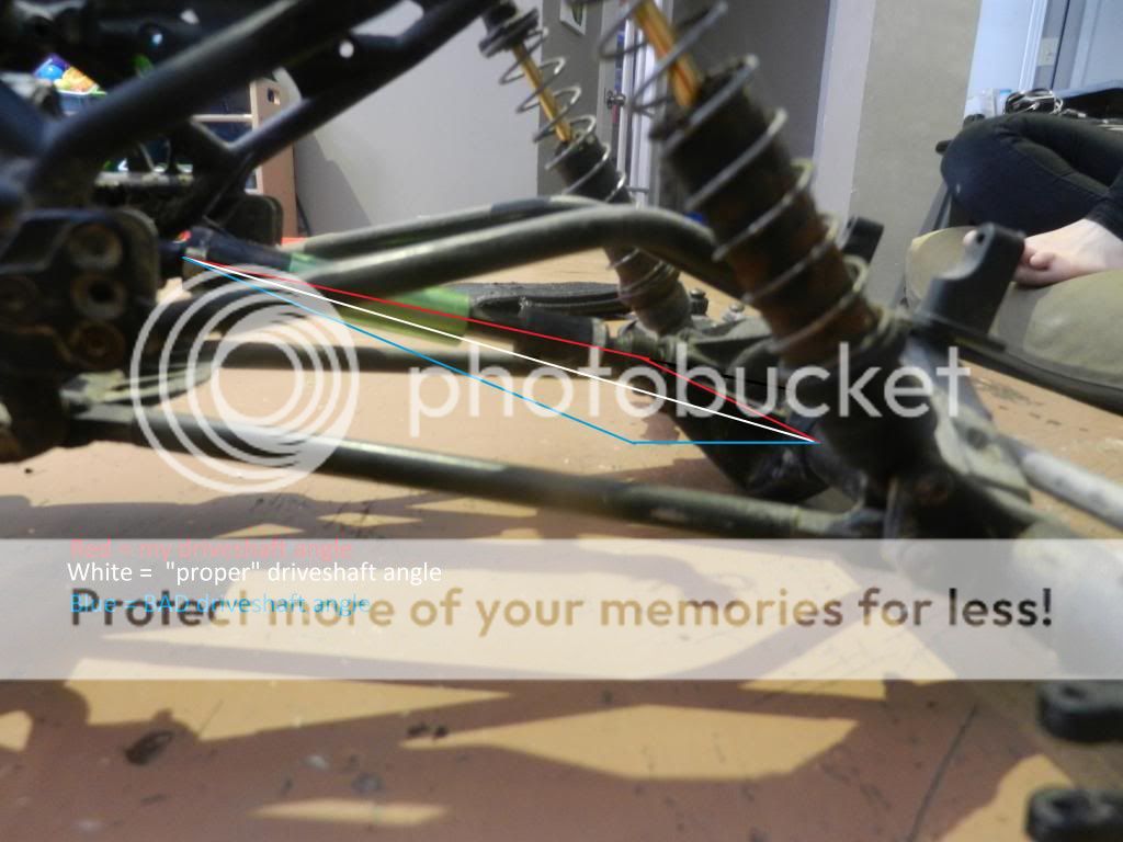

Drive shaft length is not the issue here. On a stock Wraith, the upper links need to be shorter than the lowers to keep the pinion shaft and drive shaft aligned. Referring to the the pic below (not mine btw), your setup is probably going to be clocked even farther from ideal (white) in the direction of the red line. As the suspension cycles it will increase that angle and bind at the joint. You may be able to get it to drive it like that but it's far from ideal.
