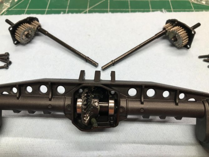

So the tear down begins. I stripped the rig down all the way to the last bolt. I'll slowly work to rebuild it and add upgrades/improvements along the way.
First up is the axles. Started with the rear. Ring and pinion was greased well, but the portal gears was lacking grease.

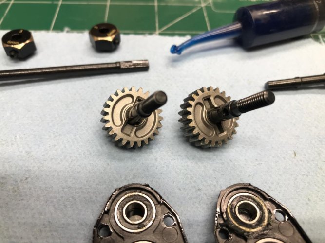

And look at that! I found one of the portal gears that was installed with the pin in the square side of the gear. The other gear was installed correctly. Hopefully this is the minor click that I was hearing! I installed pin in the correct side of gear, regreased with marine grease and put it back together.

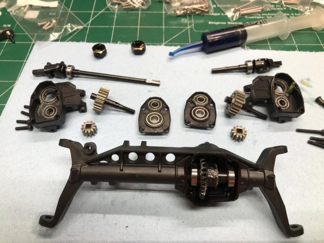

On to the front axle. Ring and pinion greased well, but portal gears were a little dry. As you can see in the pic, the pins in the portal gears were installed correctly from the factory. Regreased with marine grease and sealed it back up.
First upgrade that I do to all of my rigs. Team KNK stainless steel hardware.
Recently I saw this pop up on FB and instantly placed the order for it. I have heard quite a few people having problems with the pan hard mount on the axle breaking off. This should solve that problem! It is the Bowhouse RC SVT Panhard Reinforcement Bracket for Axial SCX10 III. Nice CNC machined alum piece that should make for a solid mount for the pan hard link. SVT! Hmm! Could this be named after our very own SVT923 here on RCC? Maybe just a coincidence!
And here is a look at the freshly rebuilt front axle with the Bowhouse RC SVT pan hard mount.

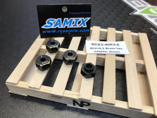

And for the hexes, I'll be adding these Samix brass 6mm hexes. These are machined with the flange in them to eliminate the factory alum spacer that goes between the outer axle bearing and the hex.

I tore down the transmission last night. Inspected the gears to make sure that they were installed correctly. Looks like the Axial builders did a great job at building this trans. I found that all gears were installed properly and it was greased very well.
I went ahead and cleaned out all of the factory grease and added marine grease to all gears and pins making sure everything that rub, slide or rotate had a good coat of grease. I also made sure that the DIG plates and fork had grease on them to help slide better and to help calm down the chatter that I've heard of some people having heard in theirs.
I put the trans back together and spun it by hand. It sounded fairly quiet and seemed to spin really good. The DIG shifted well and didn't seem to catch when being engaged. I also left the 2-speed shifter locked in low gear. Since I heard that there was not much of difference in speed between low and high gear, I figured I would just leave it in low and that is just one less micro servo that I have to worry about.
Since all the gears and pins were installed correctly from the factory, I'm guessing that slight click that I heard was probably coming from that single portal gear that I found installed the wrong way in the rear portal axle. I guess I'll find out when I get it out on the trail for it's first run.

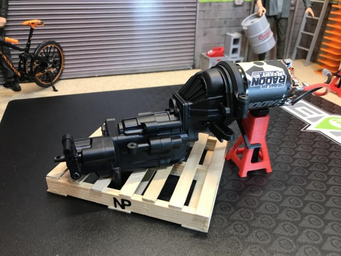

The one thing that I don't like about the trans is the slipper clutch and I believe my Capra was set-up the same way. I'm not a fan of the black spacer that is used in place of the spring that is used in some of my other rigs. I tried to crank down the lock nut as tight as I could, but think that a spring would grip a little better. I haven't seen one yet, but I'm hoping somebody comes up with some type of slipper eliminator for this trans. I never use the slipper in my other rigs and always crank them down tight so that there is no slip. Anybody know of a slipper eliminator for this trans????
So for the motor I ditched the stock 35T motor and I decided to go with the Reedy Radon 5-Slot 12T motor. I put one of these in my Marlin and really liked how smooth these motors run. Hopefully it will run just as smooth with this new Spektrum Firma 40A Smart ESC.
