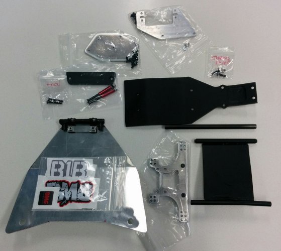

Then the B1B pics started to appear & they ticked all the boxes, all the tube chassis looks I'd hoped a Yeti would have been, so I messaged Jerry@DmG & got a kit ordered.

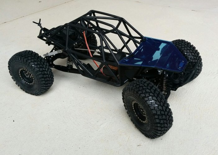

Have been piecing it together since & at the end of last week got it together enough to have a bit of a test drive at the U4RC race we had on the weekend. Still needs the front end set-up properly & it takes some getting used to the lack of steering going from live axle to IFS but I'm really happy with how it came out & even the small amount I've run it it's been really fun.

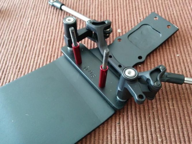

There must be a reason why the industry standard Revo rod ends as supplied with the VP links don't fit the VP carriers, but none that come to mind are particularly polite.
Much like my opinion on how the same rod ends rattle up & down in the steering rack.
If someone knows a pivot ball the same length as the Axial but that fits a Traxxas end a link or part # would be much appreciated, cos quietly I've got the same issue with the TKO trusses.

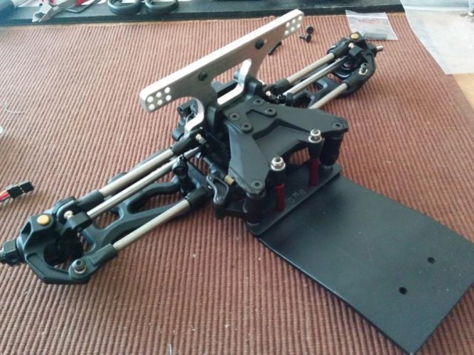

Utilised VP steering, front links, skid plate, VVDs, carriers & knuckles.
Used the Axial rear toe block & Exo front sway bar & RPM arms

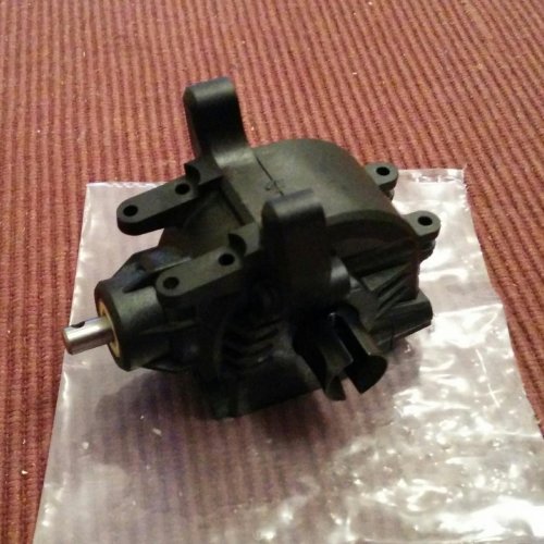

it has Axial HD UD gear set with a HR diff cup & HPI spider gears filled with 1mill Mugen diff gel
And yes I assembled the whole diff center & forgot the carrier bearings, had to pull it all apart & start again.

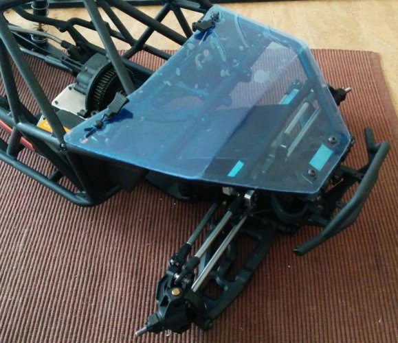

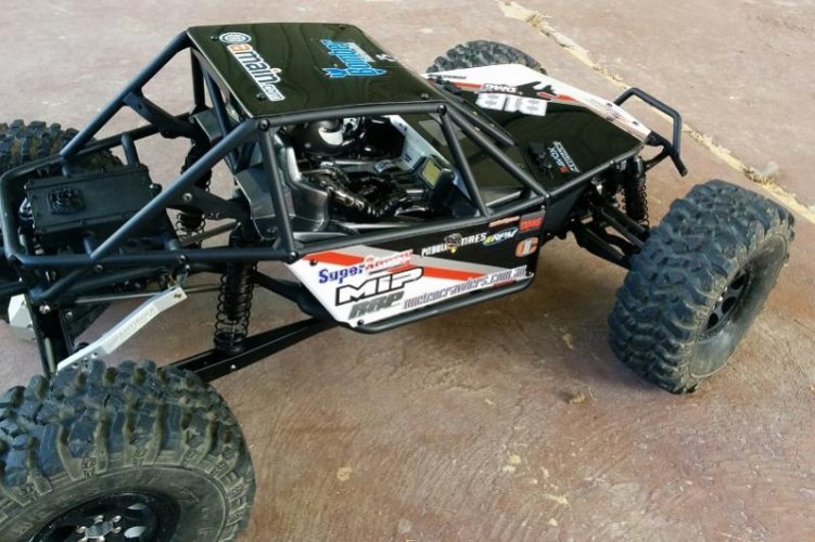

The DmG kit comes with a new ali hood but I had some lexan sheet spare so re-made it in that, my less than brilliant painting looks passable through nice glossy lexan.

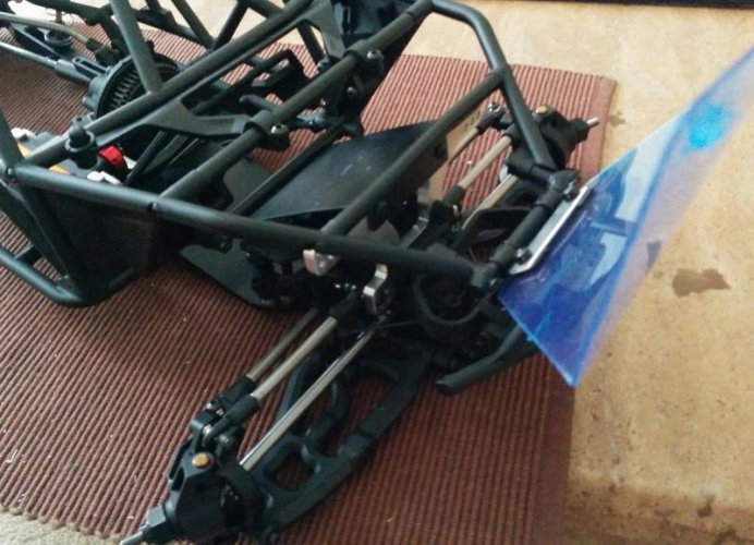

Got it all mocked up to work out the electrics

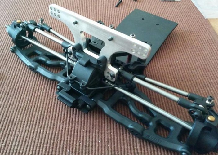

Used the VP Yeti trailing arms in the rear, with their sway bar. The sway bar links are some Traxxas that I had floating around, I think they're Revo steering links from the dual servo setup. The stock VP Yeti length sway bar links are an ideal length steering link for the B1B with Jato ends.
The uppers are VP Ti also but I think Wraith, they're some I had.
Front & rear drive shafts are MIP, Wraith length front, Yeti length rear.

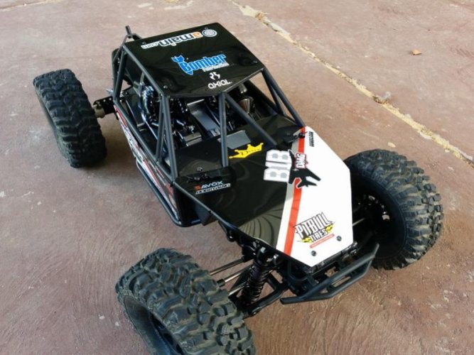

Tried it for looks with my VP Methods & PB Growlers but they're destined for the 2.2 Trophy rig, this is getting light weight CI 6 bolts & PB RBIIs.

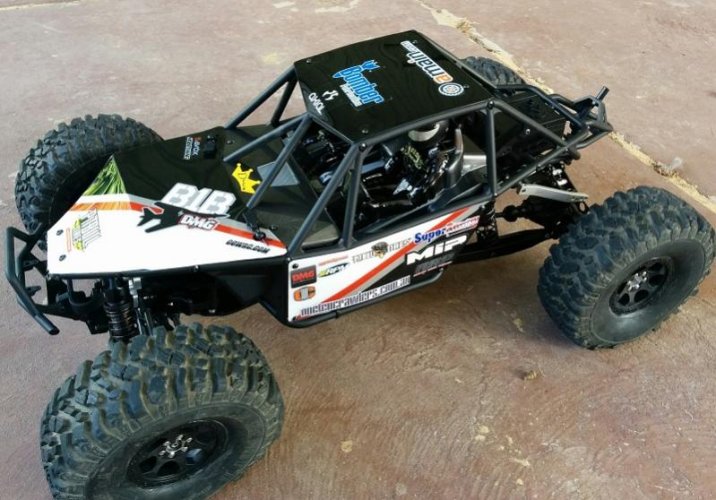

I formulated a paint scheme a while ago for my SPM crawler bodies & recently used it again for my UCFab 1.9PRT Trophy rig & liked it a lot so re-used it here, will have to make a new set of panels & re-do my 2.2 Trophy to match now I think.
