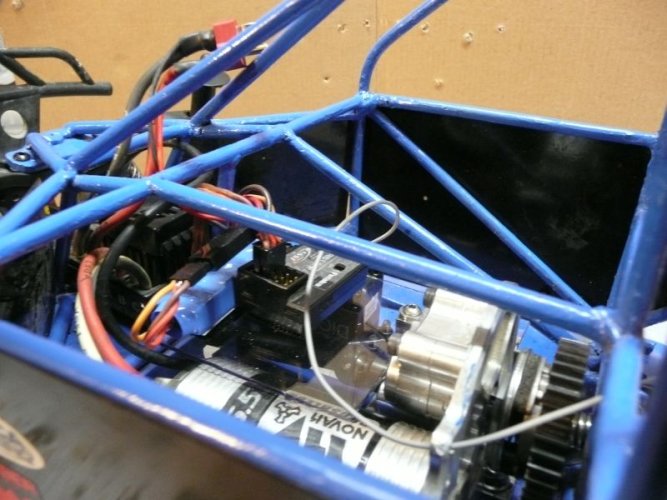

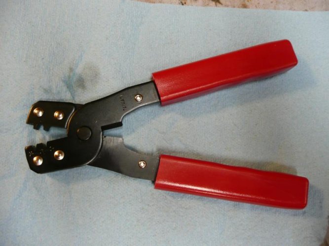

Tired of looking at your spaghetti servo and BEC wires jammed in open spaces in the chassis?
I got these from towerhobbies. There are other brands.
These pilers $21... http://www3.towerhobbies.com/cgi-bin/wti0001p?&I=LXYPT5&P=ML
And these (females) http://www3.towerhobbies.com/cgi-bin/wti0001p?&I=LXTSH7&P=M
And these (Males) http://www3.towerhobbies.com/cgi-bin/wti0001p?&I=LXTSH5&P=M

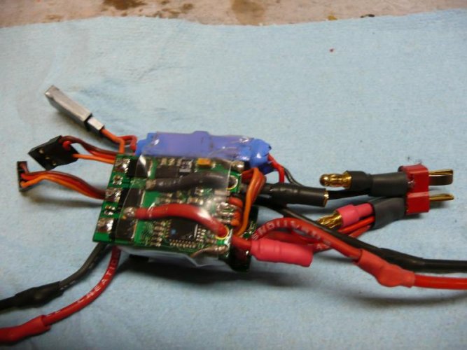

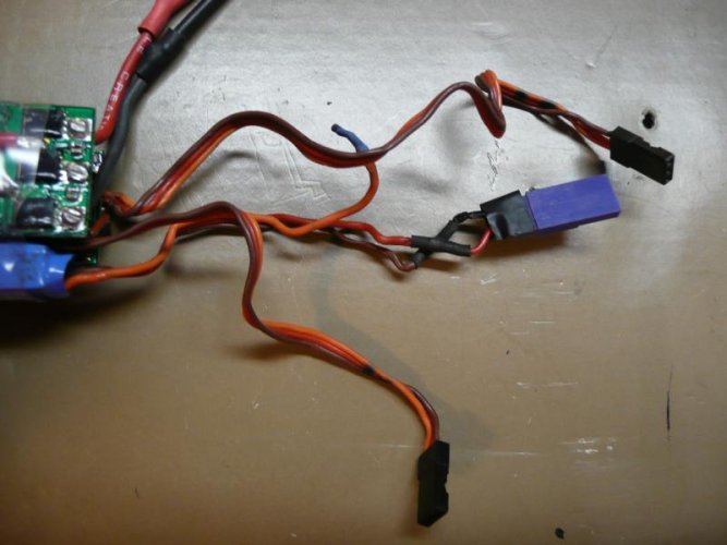

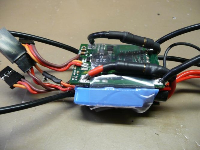

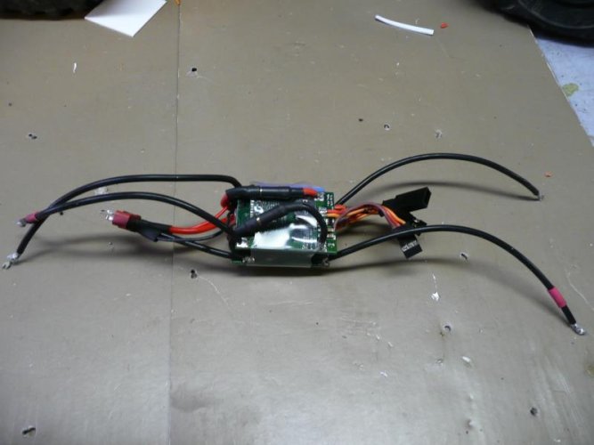

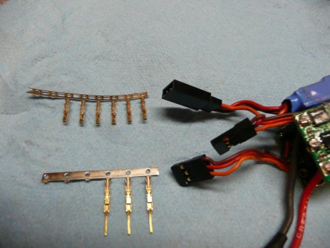

I have done two dual ESC wire shortening jobs and a few servo lead reductions in the past couple days.
I used this video...A cherry ol' chap...A little different pilers but gives a few tips. FF to 1:22...
http://www.youtube.com/watch?v=MHLz1Mck_Kg
Some before and after shots of dual Mamba Micro Pros, 1st 3 pictures and then some dual BR-XL's, last 3 pictures.
I power my servo directly from the bec and only run the servo signal wire to the Rx. So that needs a Female from the BEC.

Just got a set of those myself a few weeks back. Got tired of the rats nest.
I didn't think it would be easy but it's pretty simple and quick. I had the hang of it after 3-5 connectors, after watching the video.
Just one note. Don't crimp the "wings" on the end that go around the wire itself too much. It will cut right through the wire and cut it off. Just a good snug crimp.
I picked up a similar tool from servocity.com and am kicking myself for waiting so long to get one! Now I don't hesitate to make all kinds of custom wires/leads and it's made working on my electronics so much nicer....

No mess wiring on the 4x4 trophy truck
