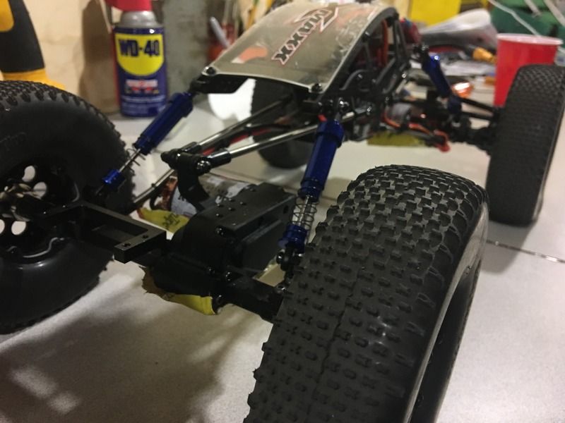

I ordered up the Dravtech comps. Having them assembled also. Hopefully its no too long of a wait, looking forward to them
Dravtech shocks are about to take over the world.
All the benefits of the best performing shock in the world for the cost of a stock Big bore.

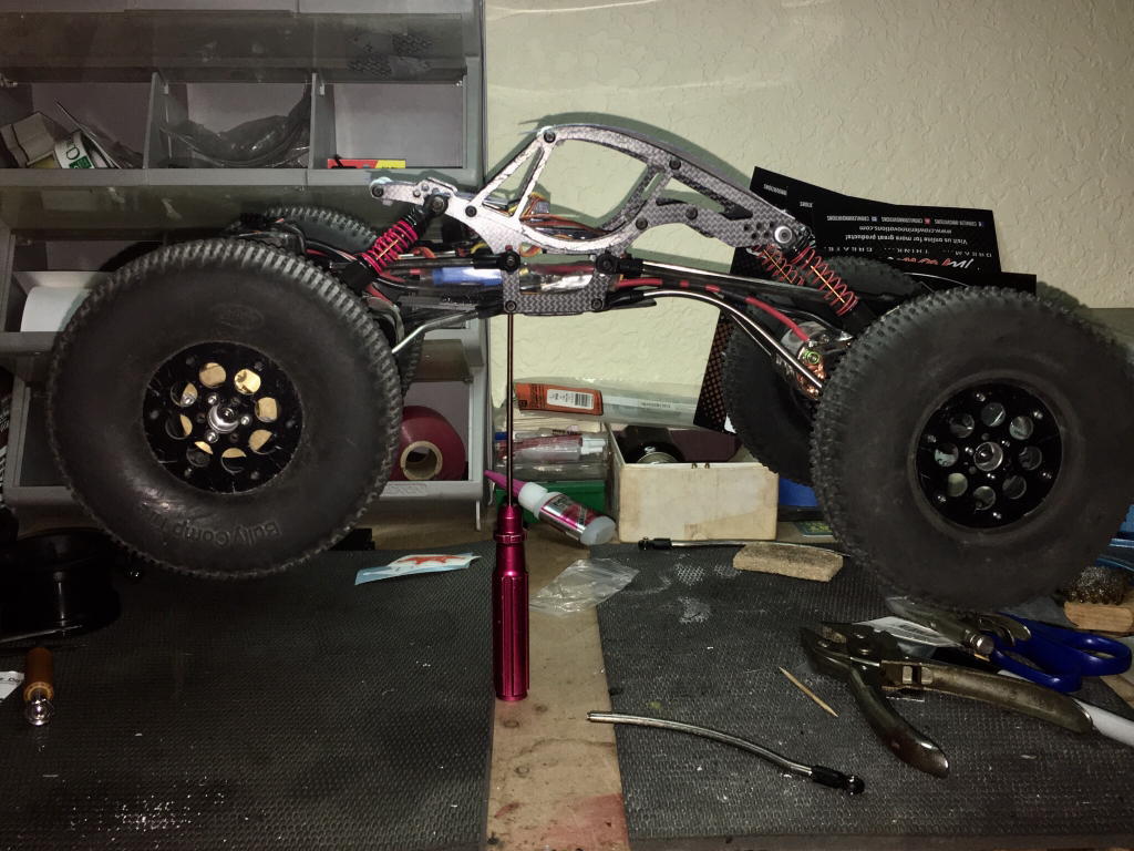

Shocks came and are all mounted up. I have yet to give them a trial run, but first impression is that they are quality. I am a bit sorry that I went with the super soft spring rates, as it seems a bit too soft. But that could just be because I am used to the bouncy stock shocks. When you push down on a properly set up Bully should it stay squatted down?
Same here. I think set correctly at rest it should both droop down and be sprung up.

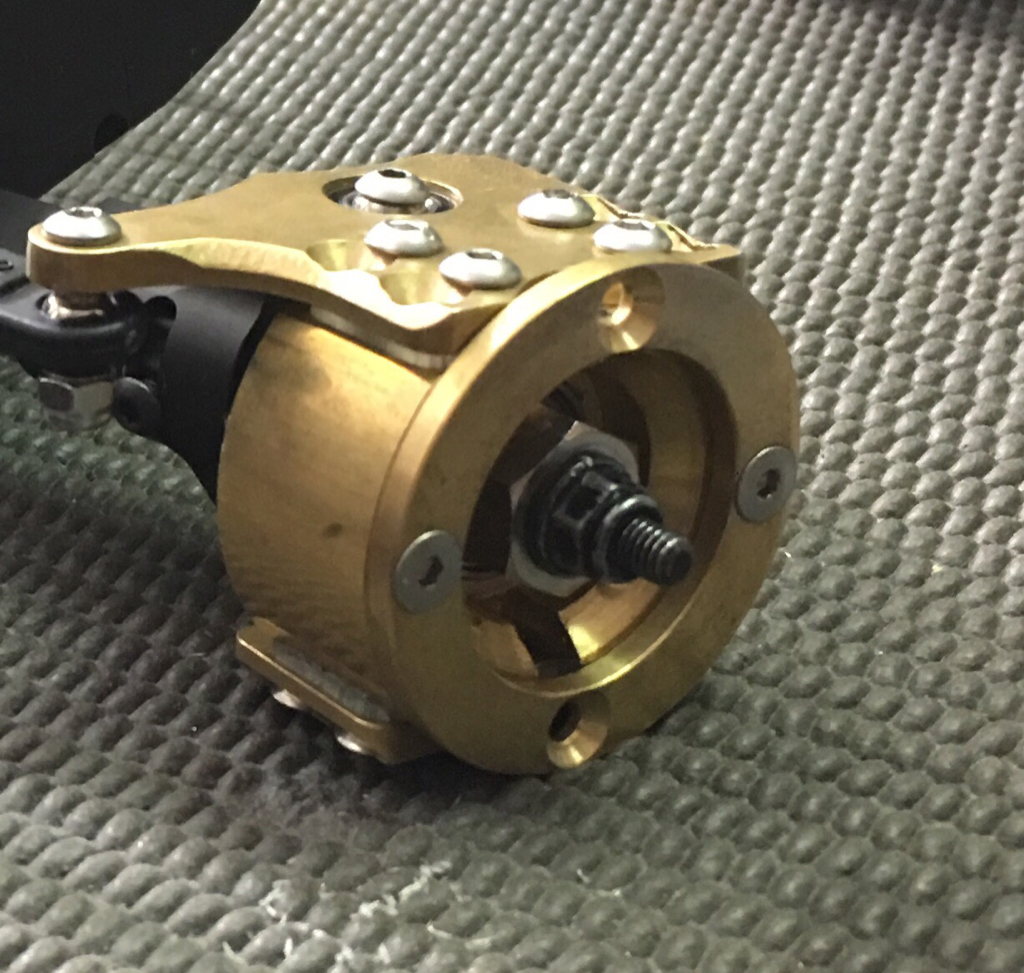

I went red and orange due to the weights I added to the knuckles
Hang up and Drive
mine stays down when I push it down. its no problem. I also opted for the super softs and they feel good to me.
