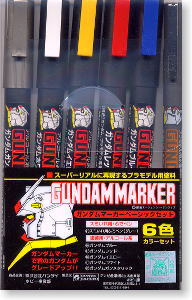

or gundam markers are pretty cool too!
https://www.google.com/search?q=gun...vc6YfZAhWCLmMKHUHdAe4QsAQITQ&biw=1920&bih=957

Looks like I learned something too!! "thumbsup"
