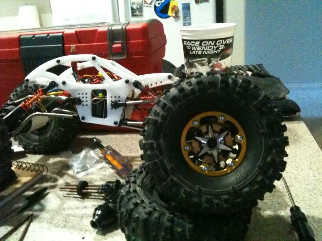

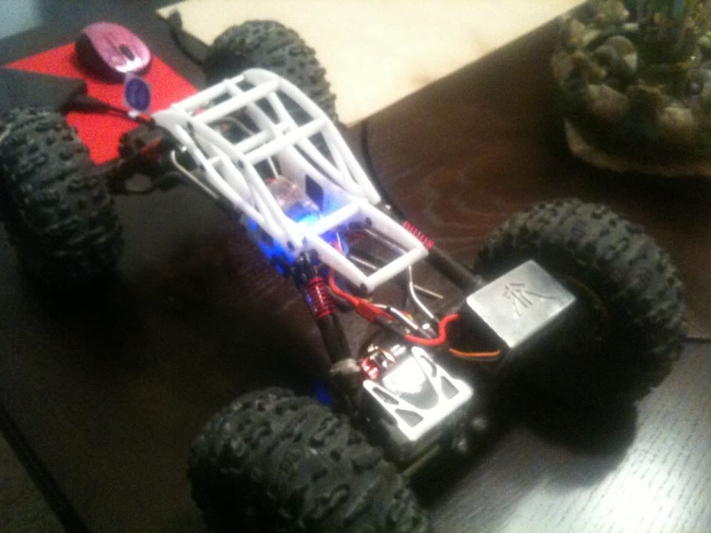

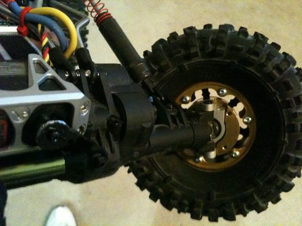

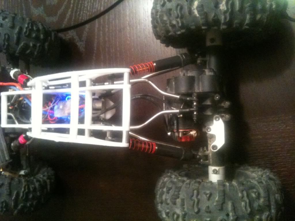

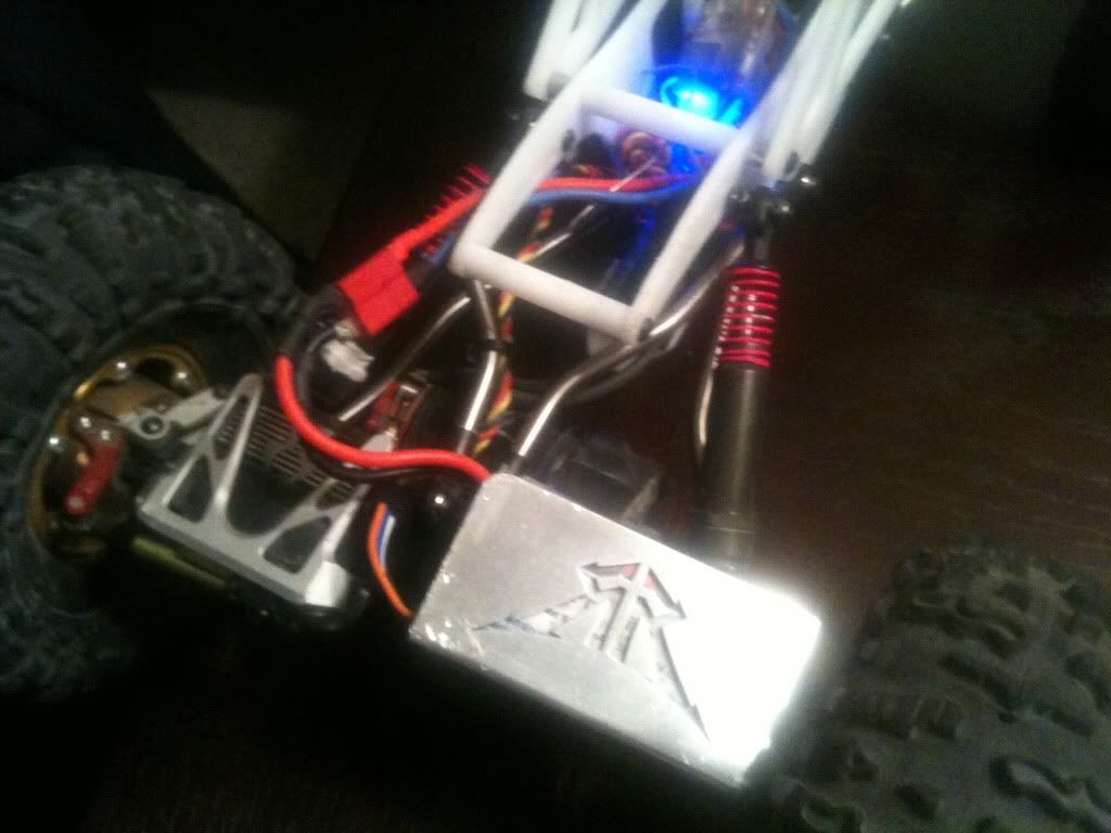

Well I decided to do a quick build thread and throw up some pics over the last 2 months I don't think this truck has stayed the same for more than a day or two :ror: which has hurt the bank but has made one awesome crawler!
Y-Town Crawlers BJV4 Chassis
Futaba 4PL
Chaotic Crawlers TI links
2-Tekin FXR's
2-45T Novak Rockstars
Novak BEC
HiTec HS-7954SH
VP Servo Armor
VP Zero Ackerman Knuckles
VP Chubs
VP Transmission Cases
VP Rear Lock-outs
Chaotic Crawlers TI Steering Rod
Axial Motor Plates W/upgraded bearings
Gearscience Gear Lube
Traxxis Big Bore Shocks W/ Cap Mod
Jeepin Doug mini T spring retainers
Mini-T Pink Springs (front) Red (rear)
Rowdy Racing Front Axle Battery Mount
HTC Servo Horn
BWD Rear Brace
Erik Dlux Knuckle Weights
VP SLW V5 respun W/ Gold Rings Front & Rear
HB White Dot Rovers Stock Foams (changing this week)
I probably forgot a few things but I hope I got most of it! "thumbsup"

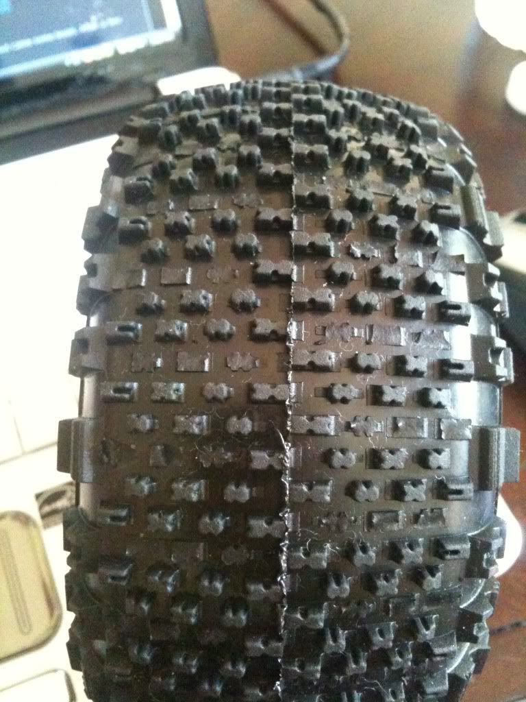

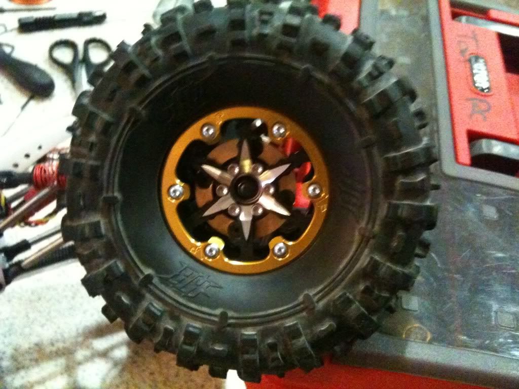

Here is the cut I have done on the boss claws for the rear
Any good ideas for the front?
Looking really good man! You can replicate what you have done there for your rear or as I personally like every other row cut up front."thumbsup" What foam setup you plan on running with the boss claws?
I done a inner angle cut on fronts and every other row on the outer half of the tire I dont have any pics at the moment Works good for dig around
foam
Well as far as foam now I have the stock foam in them but I have been looking at the crawler innovations double deuce setup probably a firm center and med or soft outer :?: But I haven't done enough research into what works best... What about you what foam setups have you tried?
