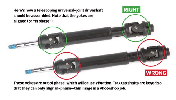

Just had a thought, is the front driveshaft out of phase?
I thought about that, but I cannot figure out the correct configuration from the manual. From the exploded views it seems like the two joints might be 90 degrees from one another, but I’m not sure. Is there a general rule, or it varies from model to model? Anyone with a picture of how it should’ be?
Edit: from the link seems like they would be aligned. I’ll try that. Is it the same for the rear driveshaft too?
The picture in the link is actually an axle shaft but it the same for driveshafts. All driveshafts should be in phase. This might make it clearer
