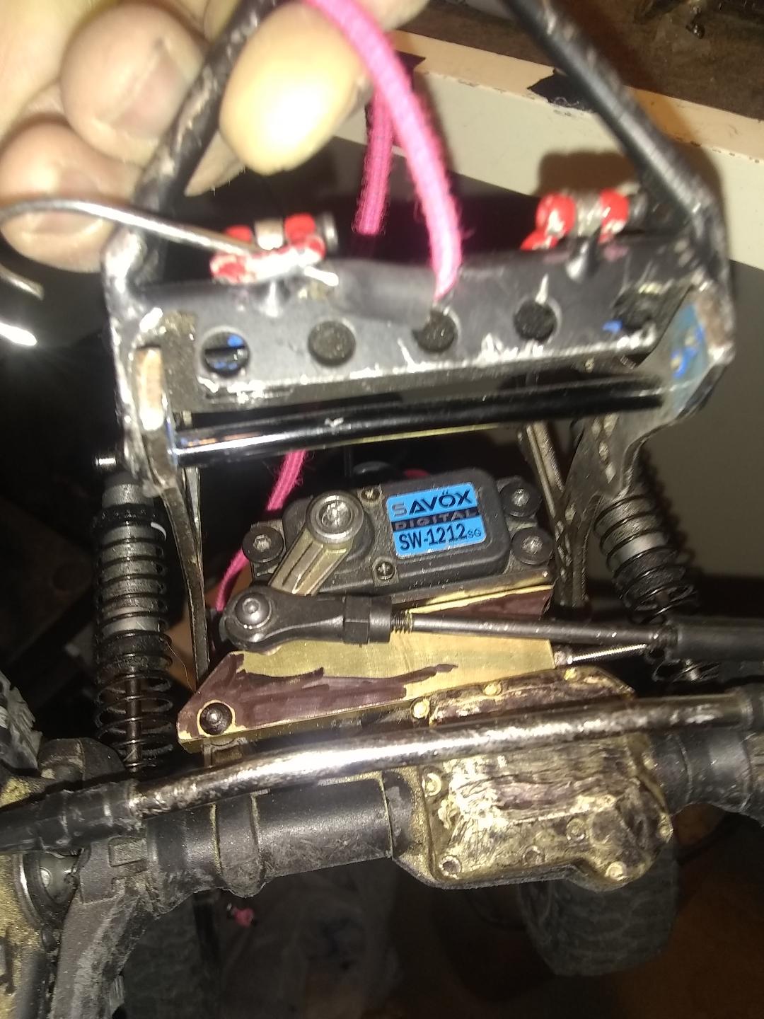

I don’t have the Chubs on this TRX4 but the inner and outer portal covers started out bright brass. I’m actually surprised more of it hasn’t scratched off. The Brass Black is pretty cool in that you can just touch it with a Qtip when needed.
Works better than a sharpie:
