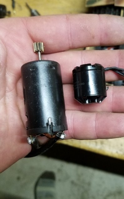

I ordered 2 Holmes 380 revolver motors and when they came in I was a bit worried. They are so much smaller then the 390 motors that were in already I was thinking I may have made a mistake. Boy was I wrong, these little guys are very powerful, and the tank is a lot faster then it was before. Which still makes me question the brushed motor kv numbers. After 2 5000mah packs back to back motor temps are 105f and esc's are 115f.
In setting up the esc I was wondering about what to set the timing at for outrunner motors. Looked online but didn't find anything specific for outrunners and crawling type stuff.
