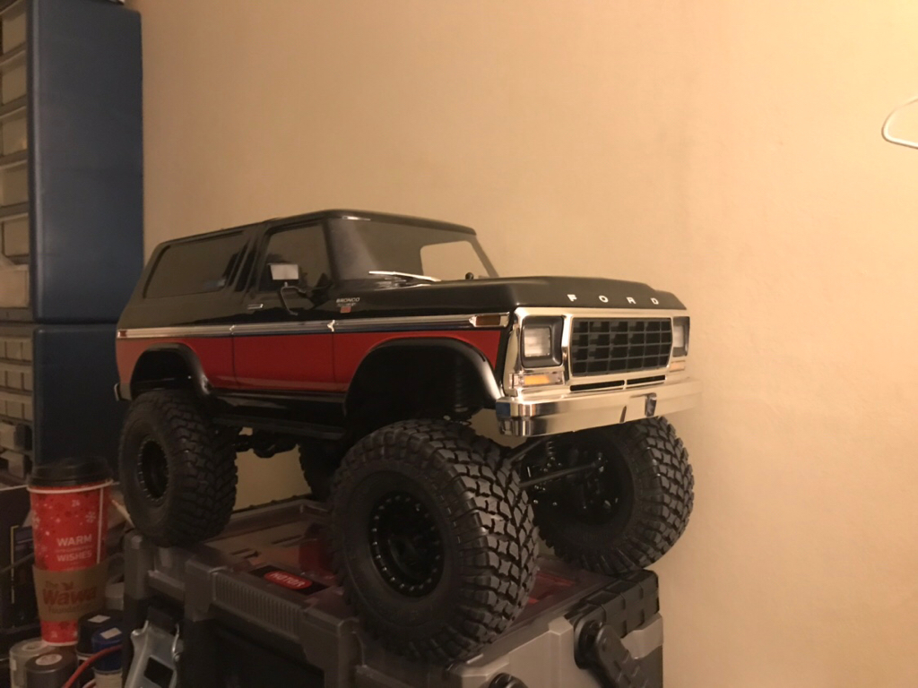

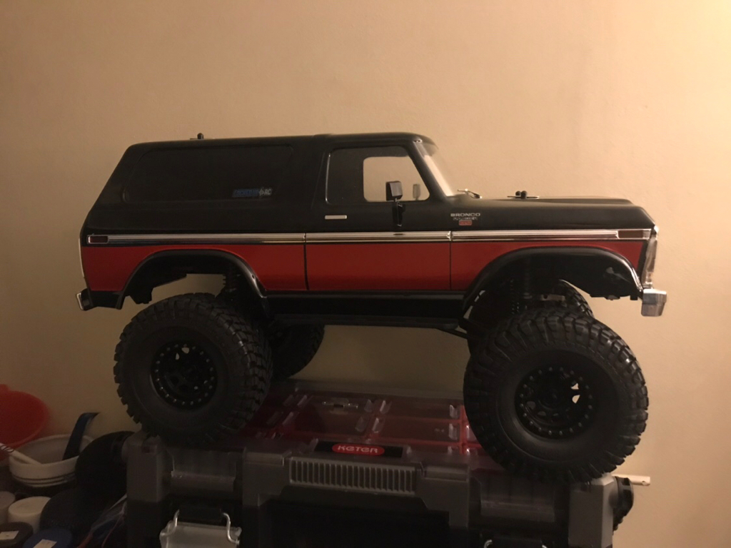

Finally an update!
It is now sitting on its own suspension once again and its new wheels!
The front and rear axle have almost all of the upgrades locked up rc offers. It’s got the locked up diff covers, fi spool in the rear, link mounts f/r, c hubs, and steel portal cases, except the covers are aluminum.
As far as electronics, it’s got a savox 1230 with an axial clamping horn, castle mamba esc and 2850kv crawler motor. Receiver is an airtronics rx481. This will probably mostly be run on 3s
I have the rear bumper coming in on monday for this and will hopefully have time to get the electronics for this thing finished so i can run it on saturday. its supposed to be 71 here!
