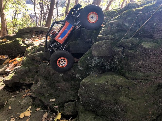

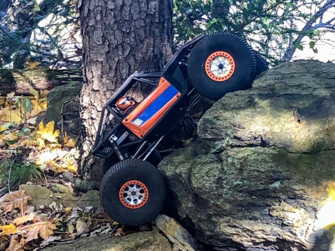

Got out today for a couple pics

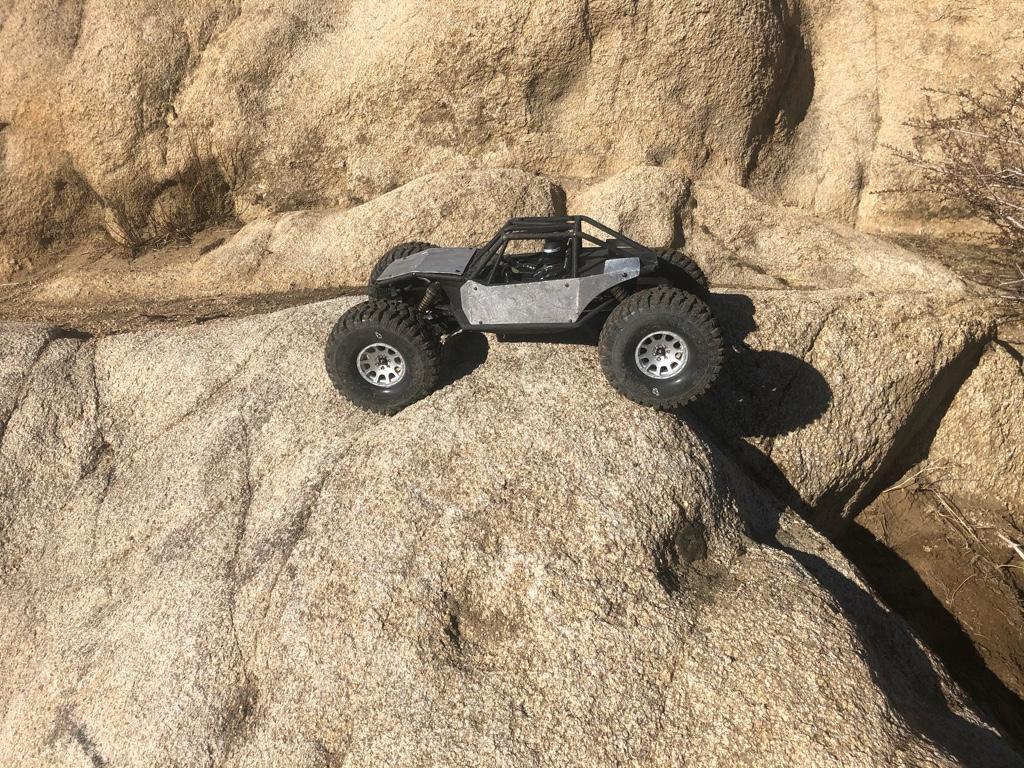

<a data-flickr-embed="true" href="https://www.flickr.com/photos/190436976@N02/50503392982/in/dateposted-public/" title="329D9C75-A223-4BC7-88CD-199A22A07397"><img src="https://live.staticflickr.com/65535/50503392982_6429639877_b.jpg" width="1024" height="768" alt="329D9C75-A223-4BC7-88CD-199A22A07397"></a><script async src="//embedr.flickr.com/assets/client-code.js" charset="utf-8"></script>
<a data-flickr-embed="true" href="https://www.flickr.com/photos/190436976@N02/50503238186/in/dateposted-public/" title="D7017F45-F28F-4402-9214-007924F8F9CB"><img src="https://live.staticflickr.com/65535/50503238186_643ce8cbb0_b.jpg" width="1024" height="768" alt="D7017F45-F28F-4402-9214-007924F8F9CB"></a><script async src="//embedr.flickr.com/assets/client-code.js" charset="utf-8"></script>
For my terrain, I like the 2.2's.
