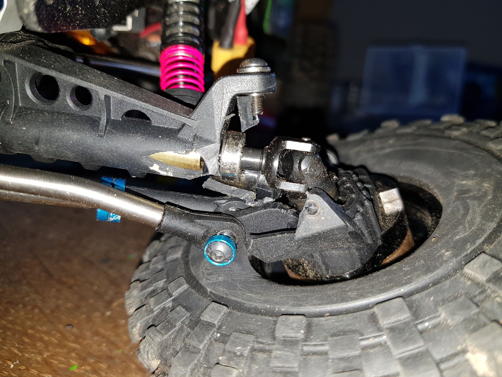

after two breaks on my front and rear axle, now a break again, the beeftubes had no effect. same position and picture than without :-(
898874-20200318-163226-autoscaled-jpg
thre break was at 20°C sunshine and under low throttle while steering around a corner
Looks like your steering stops are ground off? I trimmed mine too, but stopped before the joint could bind (right around 55°) If the u-joint is allowed to bind and the knuckle still has room to turn, something WILL break. In a 1:1 that would have resulted in a broken u-joint/axle shaft, but the weak link in your scenario is the axle housing.
Capra axles don't just break. What, exactly, happened in both cases?
Adding all that brass out at the wheel doesn't help at all.
I'd email Beef Tubes and show them this. It appears that their Beef Tubes are useless against breakage in these axles. They're good for adding weight and only that.
Yep re-check your steering trim, you may be steering farther than the axle shaft will allow.
Are they pushing that the tubes will help prevent breaking? Everything breaks lol.

Well it's true...they may not claim it adds strength.
I've never broken a Capra axle, or any axle for that matter, but some guys do. I've seen multiple breaks on the Capra and usually by the same people. They all have brass out the ass.
it was just driving low speed around a corner
yes steering stops trimmed
brass was only 100gr per side
i will buy the VP capra axles to avoid the problems
in the meanwhile i switched to ssd portals
What do you expect they're plastic C-hubs.
yes. on one side i drive 1900kV on 4s with this 6lbs rigon the other side my old shortened ar60 hat 78° steering angle without no issues and the ssd portals also work without problems.

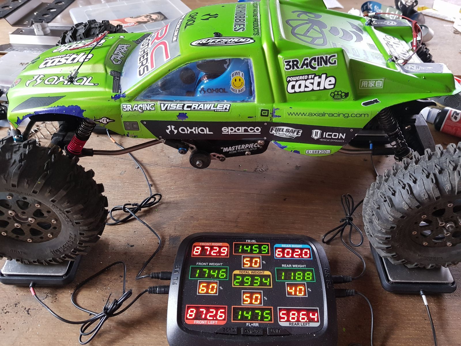

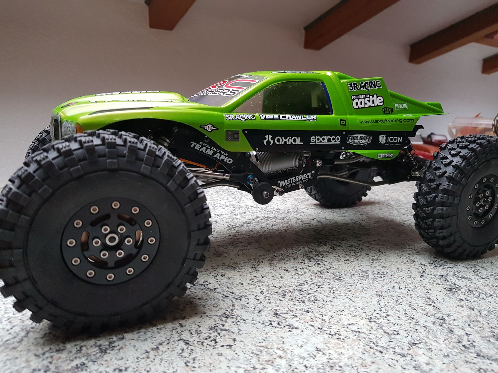

here in europe we call all brass pipes for axles beeftubes. they didn't build this, it's just made own from a 6.9/5.2 brasspipe
the rear axle is breaking also on the same point when driving without.
895301-20200308-121008-autoscaled-jpg
a little bit difficult to balance. but now good setup. until the next break :-)
weight in is with 850mAh 4s battery

I went four months with no issues. Put a brushless high torque outrunner motor on 3s in the Capra and have broken three in the last month. The wheel hangs up for a millisecond and the axle housing twists and snaps. No brass or other weights. I'm going back to the Castle inrunner.
