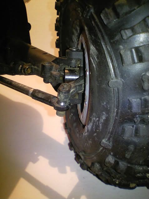

ok here it is these are on my badd bug, i held the tire back so i could get a good pic 4 u"thumbsup"
after i posted this i actually got to comparing it to the stock wheels on my sons truggy and the back spacing is about the the same but like i said the track width is narrower...about 3/4"... from outside beadlock to outside beadlock......the stock wheels ruffly measure 9.75", and with the 8 shooters it's about 9.0"
I was just worried about rubbing on links and such. Looks like it'll be good though.

well i dont know if i explained it rite or not but...they may not be any further away from links when turned full lock, but they're deffinitely not any closer "thumbsup"
Nope, you explained it just fine. You talked me right into buying the wheels. Oh, and by the way, my Fiancé is very upset with you... :mrgreen:
