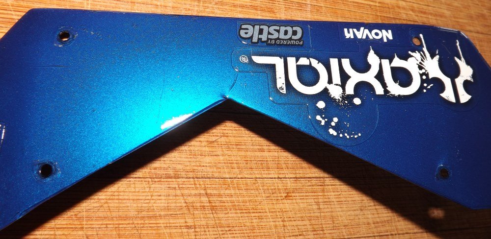

The panels on my Wraith were gouged good so I sanded them down, put on the decals and then sprayed clear coat on top of everything. It's been a few months now and still holding up good, except for where I've re-gouged the lexan! I've got photos of the process, I'll see if I can dig them up.
Found them "thumbsup"
My only advise is to make sure the lexan is CLEAN before applying the decals. I used IPA (isopropyl alcohol, not beer) after soap & water washing.
Before:
Just before clear coat:
After heavy clear coat:

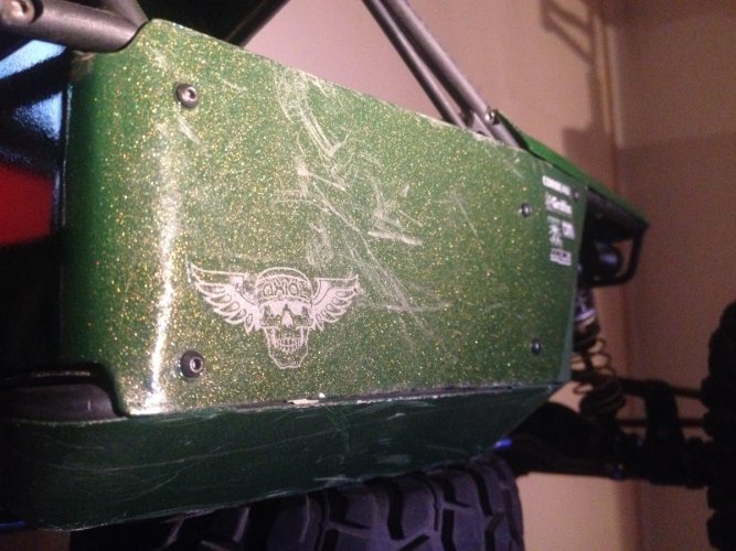

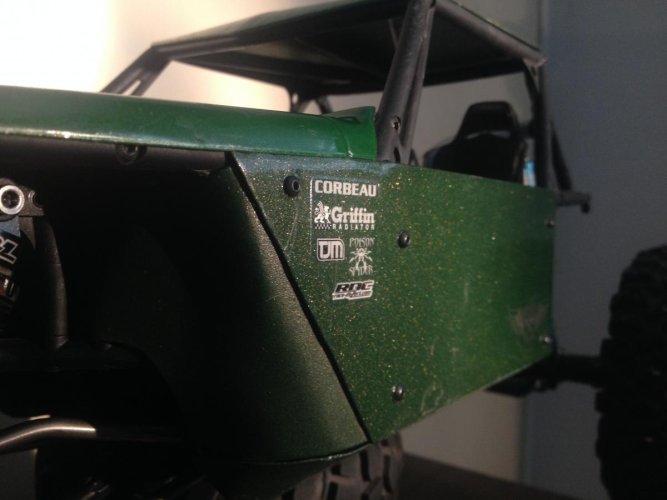

I used lots of clear over my decals for my aluminum wraith panels. I just got a big can of Painters Touch from the hardware store. Way cheaper than Tamiya. Lots of abuse so far and no peeling.

The gold "flake" you see is Tamiya lacquer over Painters Touch green. "thumbsup" I did probably half a dozen light coats with the clear (sanding over the decals in between) and then two heavier coats to get the shine. Ran out before I could fully bury them but these decals are going nowhere!
