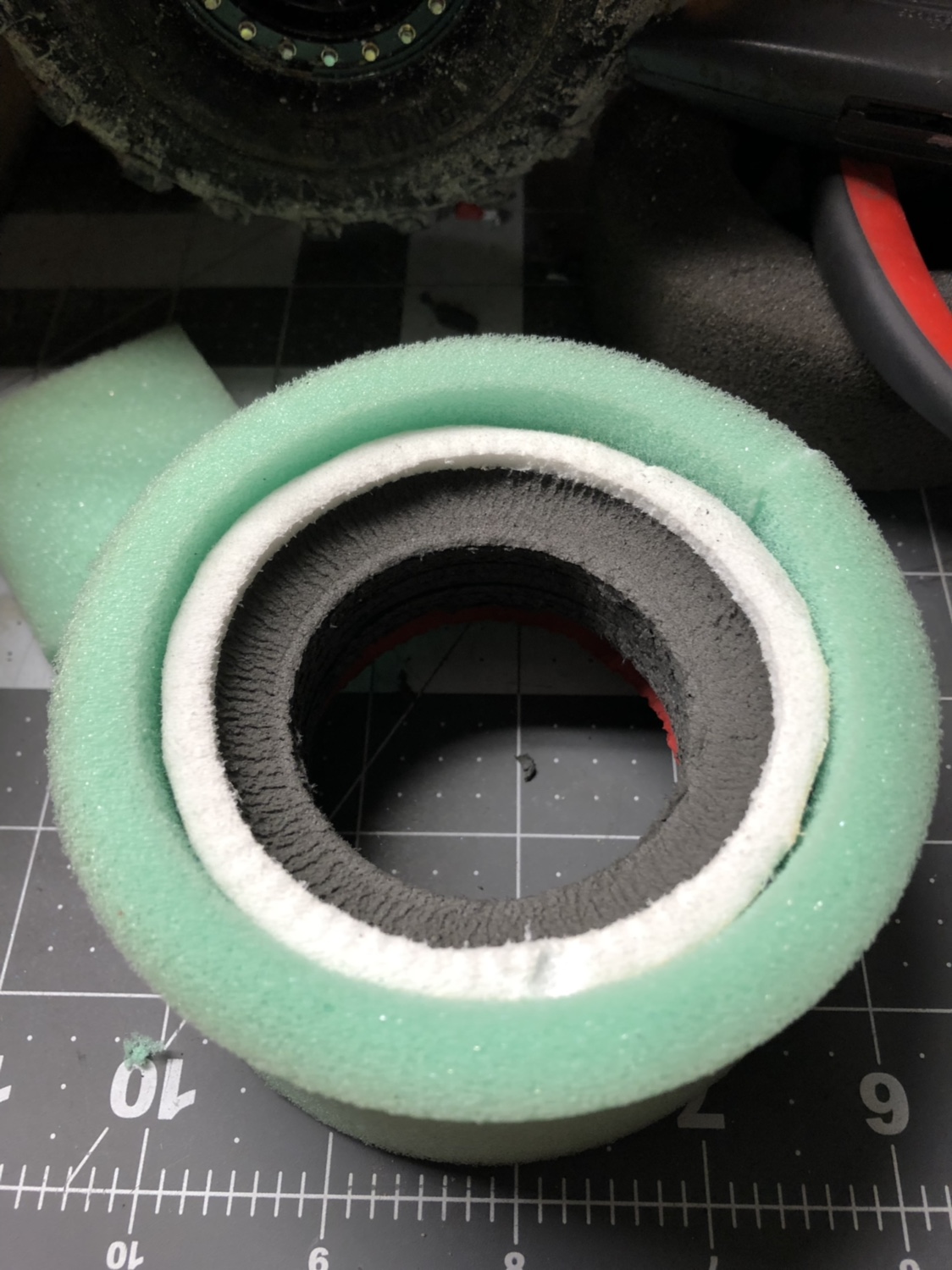

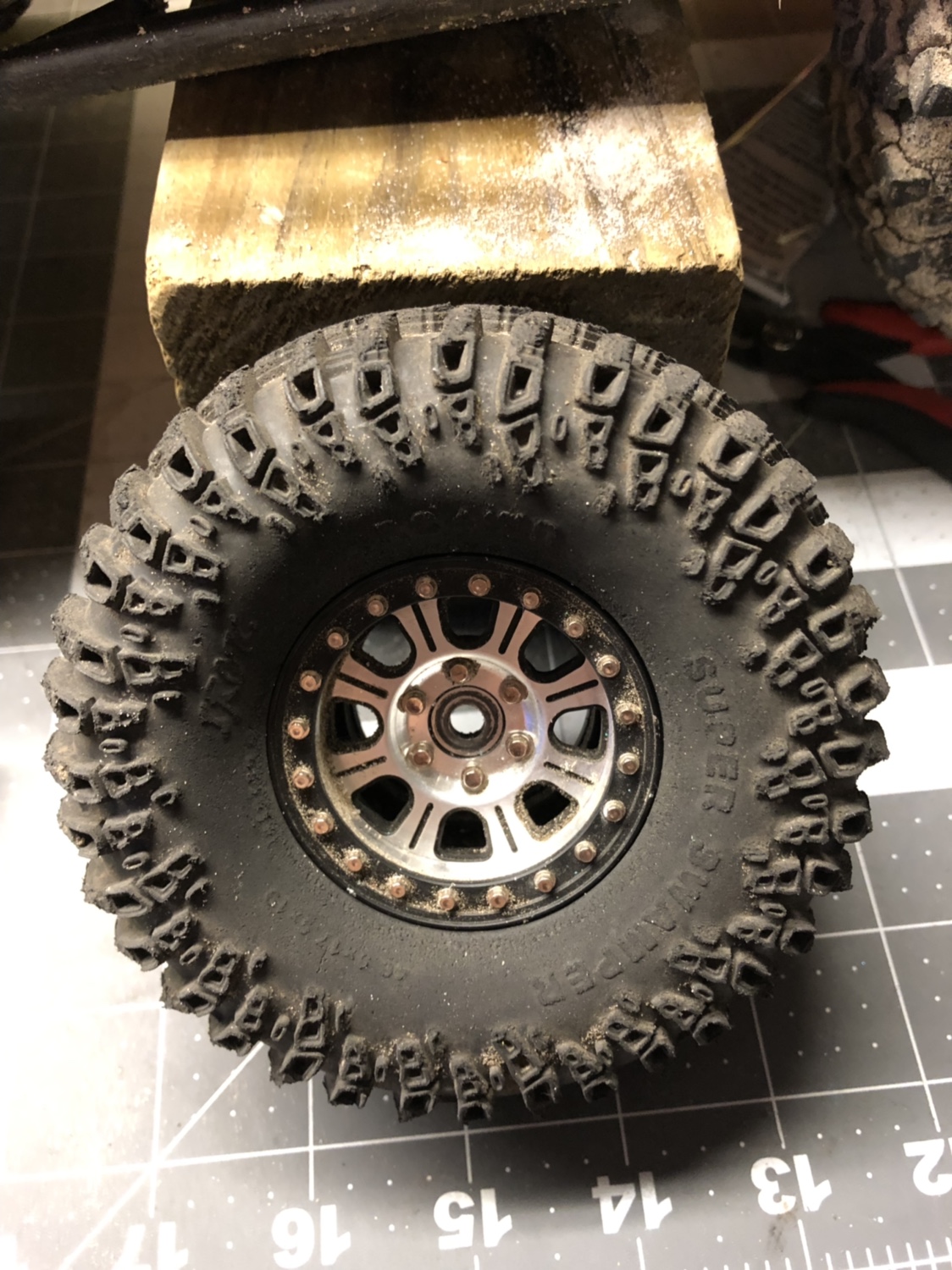

I have been working on a set. I met a really cool guy now a good friend the last time I went out to the local trail. He has fostered 4 different kids and now has adopted 3 siblings. They bought him a Scx10-2 for Father's day (red Jeep in my July 4th video) He has no budget to upgrade his crawler with, but loves the hobby. He was having a hard time keeping up with the other rigs. Due to his tires not getting any grip. So I figured since you had sent me so much. That I would help out another. I took the big inners that were in the growlers that you sent, cut them down and wrapped them with the green outer foam. Then put them inside the iRoks (kinda worn but better then the RTR tires he has) and put them on the wheels you sent with the growlers. I still have two to go, but have until the 21st when we go crawling for my birthday to get them done. Just passing it forward trying to help where I can. Here's a pic of what I have going.

Passing it forward, I'm proud of you!!! If you need anymore let me know. "thumbsup"

I try to pass it forward anytime I can in my day to day, but this is the first opportunity I've had to help a brother crawler out. Thank you again Ernie! Looking forward to your next trip to Florida :mrgreen:

I know that you and Kayla both do! "thumbsup"
