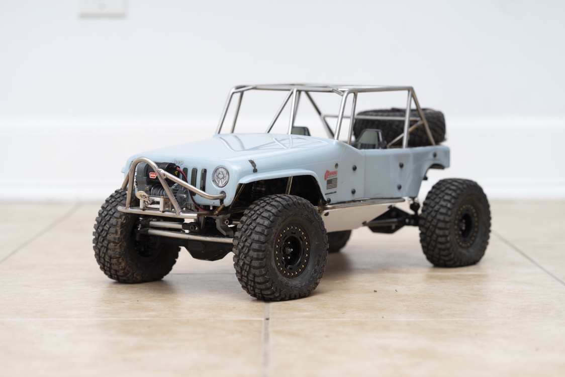

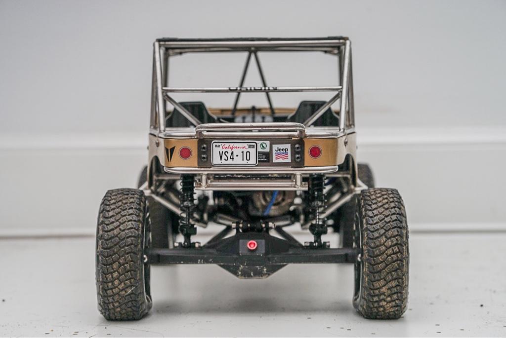

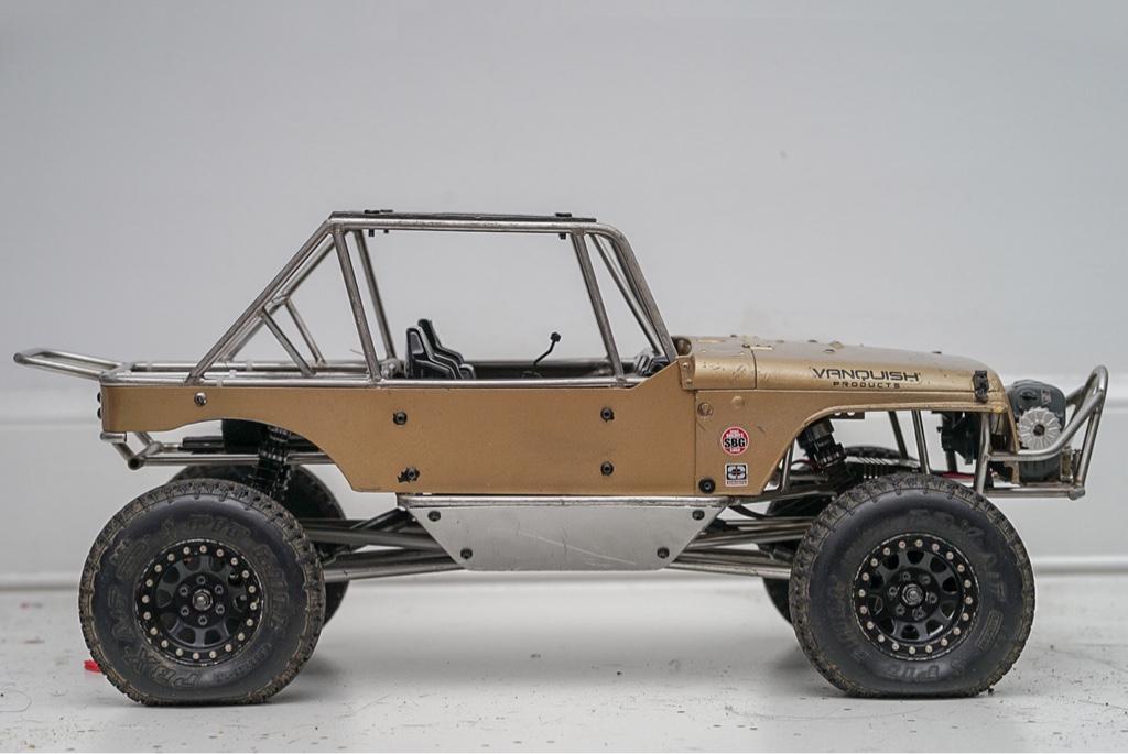

Here's something I've wanted for a while! Contacted a bunch of builders, but almost everyone was either not accepting orders or just didnt have time to do custom work. I found this chassis and decided to go for it.
It's an LNL HPM RS-X1. Fully tig'd solid stainless. The welds are better than anything I've seen from TFL or any other Chinese brand. I've ran it a bunch, and it's starting to get a little dark at the some of the welds I didn't clean up so I'm going to break it down and pickle it or something.
Base was a vs4-10 black I got as a gift from the other half. Now that I'm running SOA, the best part of the kit is in the bin!
Specs:
- LNL HPM RS-X1 SS chassis
- Vanquish vs4-10 trans (axial AX10) with hurtz dig v2
- vs4-10 skid (I had a spare because my kit had a bunch of defects)
- vanquish f9 axles front and back with SOA mount
- incision axle shafts and vdi's
- vanquish locker and stock vs4-10 gears
- protek 370TBL servo
- hobbywing axe 2300kv combo
- incision links all around
- axial g6 body (for now)
- RC4WD 8274 with wired BOOB controller
-LURC wheels on PL km3 predators (4.19)
Everything works together great as it's just a heavier vs4-10 basically. I'm having TONS of problems with my transmitter. I think I've narrowed it down to the 4th channel not recognizing a neutral position. With the winch plugged in, it winds non stop. If I switch the dig to the 4th channel it immediately flies to one end of it's swing and locks up. So for now the winch isn't connected. If anyone has any ideas please chime in. I've literally tried everything to get this thing to work. If there was a way to recalibrate the transmitter, they certainly don't make it easy to find out how.
Thanks everyone. This is what it looked like in its final iteration.
