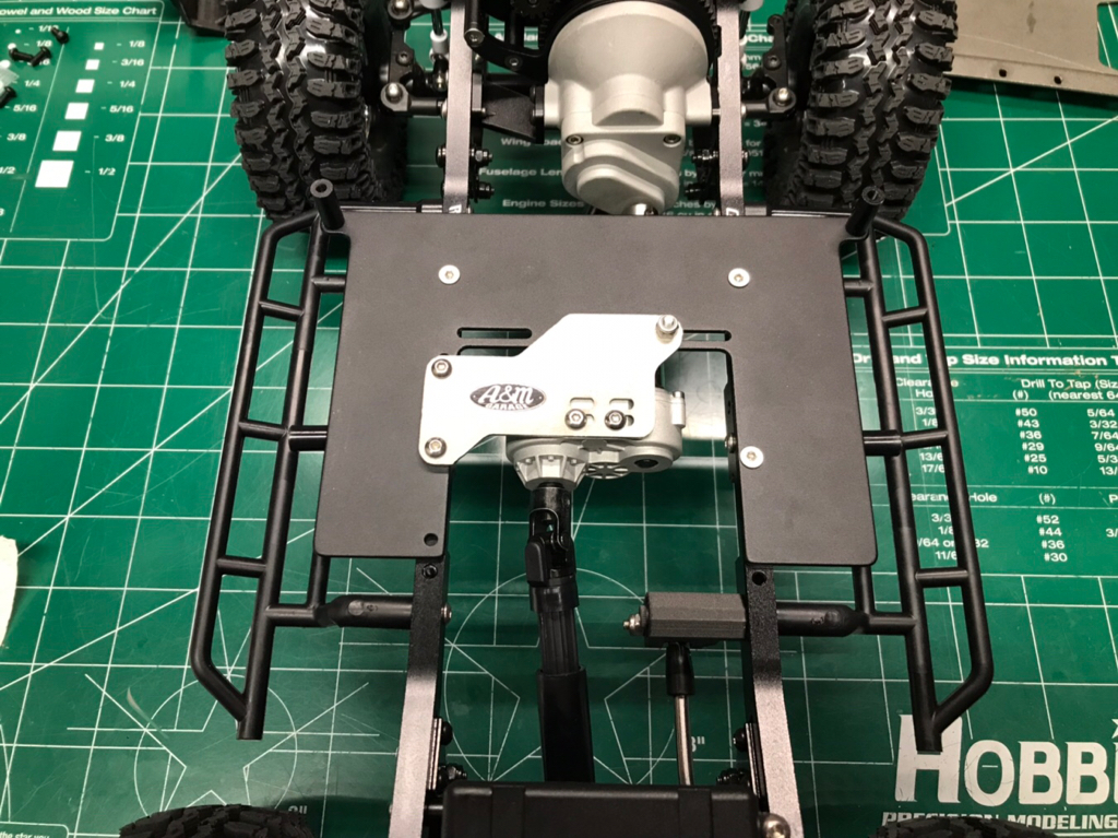

Congrats on the MC! I think I'd go A&M skid. That's what I'm planning on anyway. Love the design, quality appearance, and profile of it. Grab a set of MIP HD shafty's too and just apply that "early Christmas gift" credit! ;-)
Are these drive shafts on the Marlin any better than the OGs?
From what I remember, they where pretty crappy.
I know when I install a raised skid, I’ll need the additional length, but I was wondering if they are ok to use for now?
Congrats on catching a Marlin! I recently purchased one and it is a blast to drive.
I’d recommend the A&M skid as well. I just installed one in mine. It tucks the t-case up into the chassis nicely.

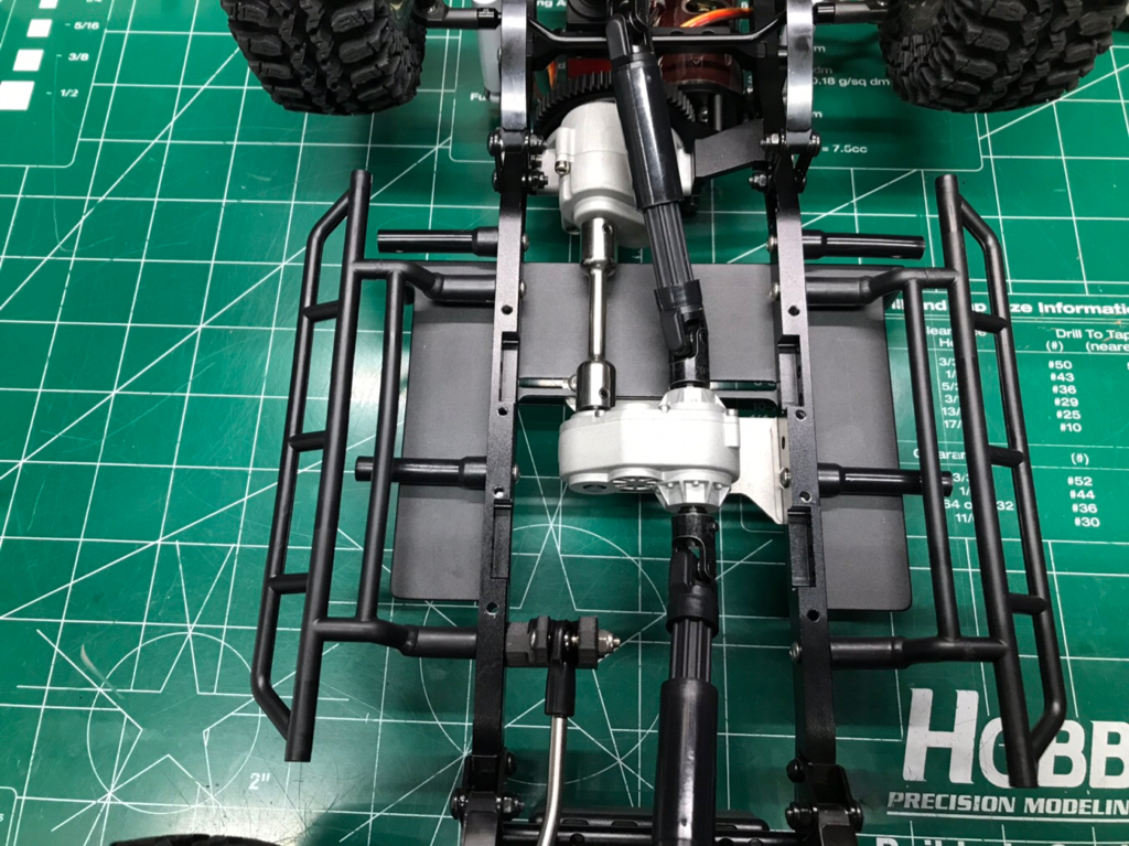

Here is a side view:
The only problem I had after installing the skid was the front driveshaft was a little too short. It would occasionally pop apart. I ended up buying the Super Shafty MIP HD shafts designed for the A&M skid.

After installing the A&M skid, does the solid drive shaft from the tranny to transfer case still line up?
Do you have any pics?
Yes, it stays in the same place. I had to open t-case and move the input shaft to the other side of case.
I see, so the A&M skid flips the transfer case and the top bracket is the attachment point for the transfer case.
Awesome! That helps tremendously!
Thank you!šŸ‘šŸ¼
Thank you![emoji1360]
No problem! It also gives you the option to overdrive the front axle if you want.
