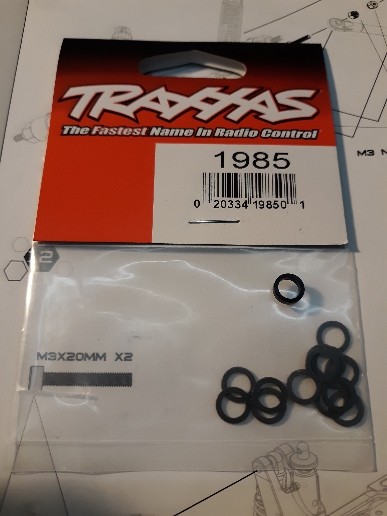

One thing I wanted to note...I hate slop BTW...the transmission, while a very nice piece of engineering, does have a bit of slop in the top shaft and outputs. This can easily be cured by swapping the stock slipper eliminator spacer for a total of 4 Traxxas 5x8x0.5mm fiber washers. I used two behind the top shaft bearing to push the top shaft completely into the trans, which fully engages the pin in the top shaft with the top shaft gear. The other two fiber washers can be used behind the slipper eliminator hub just like the stock spacer.
I have also shimmed the outputs tight with the same washers. One between each drive shaft and bearing. And the results are quite nice. No in/out slop in the shafts, full pin engagement in your gears, and it's silky smooth. [emoji41]

Good info! I'm far too lazy and impatient to try to take the slop out of everything. Sometimes finding the correct spacer or shim is a chore.
[emoji23] And I couldn't let it go. I woke up bright and early this morning and started tearing the trans back out. But I have PILES of shims for this very reason. The Traxxas units are my go-to most of the time. At 0.5mm thick, they eat up gaps quick.
The one size I don't have is for those damn spool bearings. A 7mm inside diameter is hard to find. Going to have to try to find some with a 14mm outside diameter to match the bearings, and shim the bearings in on the spools. I'll be sure to post up some parts numbers when I find something suitable.
