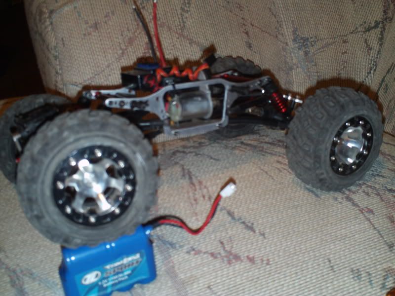

I think you could run any Losi mini-t shocks, also the mini late or slider shocks (not sure). I ran mini-t shocks on mine, then went to Traxxas mini GTR's for the 1/16 slash/revo just for fun. Not much flex on that set-up, just enough.:) If ya do a Google image search on the chassis, alot of the cool pics will send ya right back here with some tech. Its a cool set-up, but im ready for like a rockshow or miniGC3.
Well I got it in a trade and it has stock droop shocks on it and i doubt I will want to use those... But who knows.
I had the unfortunate experience of my chassis breaking. I think it was one of the earlier chassis because it came with a clear plexi glass type skid plate. It ended up cracking where the lower link connected to it. So now I've gone to the darkside with the darksoul chassis. This chassis is a beast.

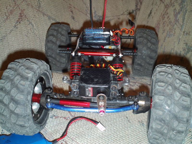

As far as the setup I had with the DNA Chassis, I ran Mini-T shocks on the back and Losi Aluminums on the front. I had the losi's running inboard on the furthest hole back.
