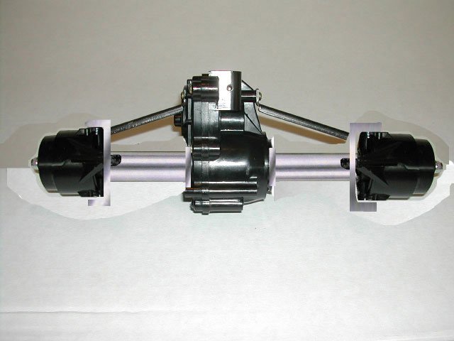

Here’s a sneak picture of my axle.
I haven’t finished all the machining on some parts, and the axles, shocks, & shock mounts shown are just there for measuring/fitting purposes. Don’t ask questions on how I did it until after the Build-Off competition. I’ll have a little write-up on it then.
My final design will be to replace all plastic axle parts with aluminum.
