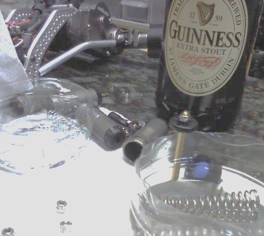

I think I'm confused now but....I think I was confused before too:lol:
I am running up and down the stairs between the basement and my den to use the PC.....I think the guiness is making me levitate...is that possible?:shock:
