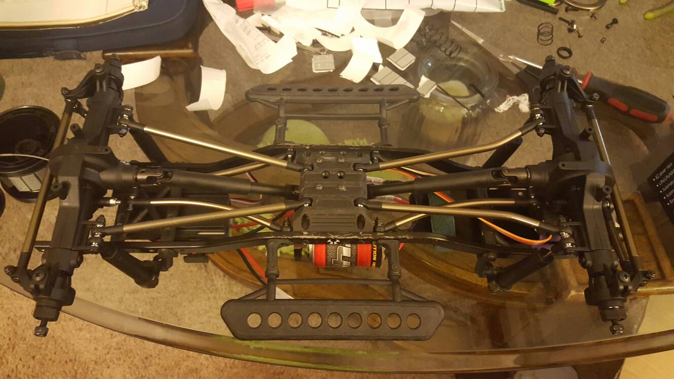

Those that have converted or swapped their Everest parts to the Axial chassis, any chance you can post pictures of your linkage? I worked on mine for a while and haven't found a way to have a correct pinion angle, without building new links. Thanks for any help.
I started with the X-Trail chassis rails, then switched to an SCX chassis because it had all the crossmembers, hardware, and links.
You'll have to use the E10 links, or make your own. The conversion is pretty simple if you don't have to fabricate any parts. Shorter shocks would be better, but you can use the Everest shocks. I ran mine a couple times. Works fine, but I'm not concerned about the scale look. I've since found a toy rc that's a smaller copy of the Axial Wraith. I'm now in the process of making links and swapping my E10 axles/trans/electronics onto it, along with 1.9 tires.

Here's what I'm swapping to. I smoothed out the "skid plate" to mount the trans and speed control. I still have to cut out a hole in the passenger side of the interior to clear the motor and spur gear. I'm also having to make new suspension links. The E10 and SCX10 links are way too long.
