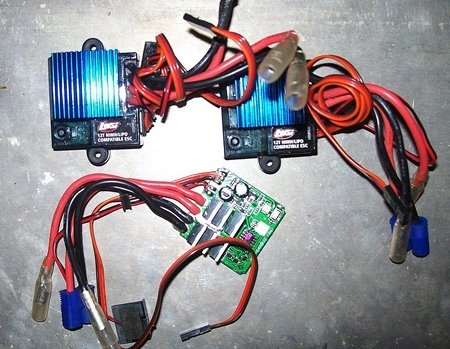

I have the electronics figured out. A while back, I got a hell of a deal on 7 Losi Strikes for a family fleet. They were the defective ones (I was aware when I bought them), and Losi's CS made me as close to a fanboy as any company ever has. They replaced the ESCs without question, and allowed me to keep the bad ones. Here's the deal: The reverse is super weak in the regular mode... but in crawler and race mode, they work fine.
They are only good for 2s (12T), but that fact makes other design considerations moot. I will be running mounted A123 cells, so I will be working with 6.6V... which makes it unnecessary to buy a CC pro BEC. Cheap servos will either have to dance to that music, or burn... "thumbsup" First up will be 3 $12 Tpro MG946Rs... :twisted:
This system will only cost me the price of a couple good motors... not bad idea anyway. I just need to get some advice on what to buy. I'd like to get more speed, but not at the cost of (2) 3s ESCs and a good BEC.
Any thoughts? Anyone?

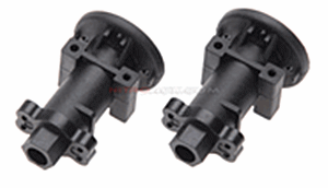

I like the Max Stone axle housings a lot better.
http://www.nitrorcx.com/18maxstrocr.html
They look like they could be modded by shaping the inboard flange to match. If anyone has a 'stone, I'd appreciate knowing the flange diameter, and the length of the housings from the base to the pivot hole.
I really want to clock these axles before making brace/servo mounts, and those housings have stout, low mounting points.

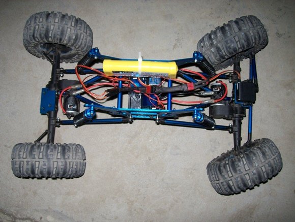

I had to see what a difference getting rid of clod stall would make, so I threw it together and ran it. I'm glad I went this route.
It's a rat's nest, but when the Punk shows, I'll wire it right.

I went ahead and ordered the 'stone parts. A $10 experiment. Those parts are the only thing I like better about the 'stones. I'm pretty sure I can make them work... if the length is close.

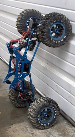

This is as far as I'm going with this until I finish the custom axle/trans housings. Those parts will be here tomorrow. It'll end up with axle mounted shocks and batteries, so DIY custom shocks and TVPs are coming soon. It's obvious there is a lot to lose in plate weight, and gain in CG.
It will already climb a wall to the degree shown, and cross RR tracks without hesitation... so it's already becoming a fun urban rover. The A123s actually didn't reduce wheel speed as much as I feared, and I have enough torque (but maybe not a Mad dosage) for now.
Also coming tomorrow are the other 2 cheap servos, and a cheap FPV wireless rig. The servos will be wired directly to the batts, and the cam setup will be detachable. I'm kind of excited about trying crawling from my wheelchair. "thumbsup"

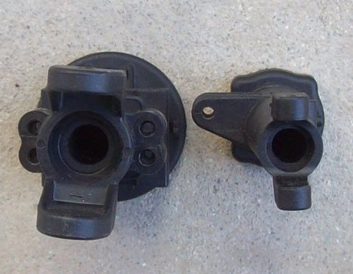

Side by side. The stone's take 8 x 16 x 5mm bearings, the MT takes 6 x 10 x 3mm.
The mounting flanges are completely different... enough so that it seems to make the most sense to graft the MT flange to the Stone tubes. If the MT flanges were cut with some tube left on them, it could be turned to fit into the bigger ones... giving tubes with nearly double the thickness at the base, heavier Cs (replaceable), and at any length desired.
If CV axles can be found close to the stock lengths, these parts can easily be combined to fit them.

The Stone tubes are 20mm OD, and 14mm ID (nearly out to the hex C mounts). The MT's are 7.5mm ID, and >14mm all the way to the base of the Cs.
As soon as I have definite lengths... I want to use common CVDs, without mods... I'll turn the MTs down to a nearly interference fit, and have an infinitely and repeatedly clockable (set and pin) setup with nearly 7mm thick walls (full length, if desired). That ought to hold a screw or 2. The Al Cs and knuckles would finish this nicely (but not cheaply).
