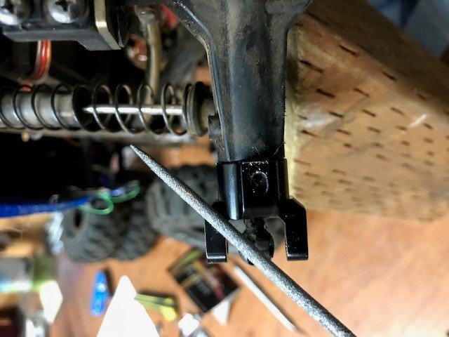

Jus thought I would post an update. I could not find any brass knuckles for OG scx10. I wanted to replace both the chubs and knuckles. Once again being cheap bites me in the ass.
I bought the "Hobbypark Steering Aluminum Knuckle & C Hub Carrier (L/R) Set for AXIAL SCX10"
https://www.amazon.com/gp/product/B0717994V7/ref=ppx_yo_dt_b_asin_title_o04_s00?ie=UTF8&psc=1
Got it the next day and found a few issues.
The first pic shows how the scx10 chub will not fit the Everest axle. I was aware of this based on previous research so no big deal. Shave a mm off each side and good to go. The screws that came with the kit were too long and touched the shaft on the inside but no big deal as the original screws worked fine.
The second pic shows a more glaring issue. The holes in the new chubs did not line up with the holes on the axle when seated fully. I was able to solve by using a mini HF bastard file, luckily it fit the hole perfectly and didn't waller it out too much.
Beyond this they seemed to work well and the knuckles fit without issue. Steering is not any better than it was with stock knuckles with nubs shaved off but for the price I am ok with modding a lil bit. I used the bearings that came with the new kit for now and really didn't test fitment of other sealed bearings. They look like really poor quality bearings so prob will be replacing soon.

the ones i used had sloted screw holes out of the box i think they were strc or some cheap chinesse brand but they were a direct bolt on after the nubs were shaved
the only way to get better steering would be the wraith c-hubs and knuckles i cut groves in the nubs and mounted the wraith parts on no $50 beef tube mod
