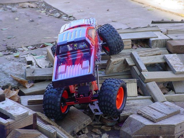

I used rs10 esc and 3channel radio. Almost done with this, well...almost.
Is there a write-up or how-to on adding rear steer? I understand the components, but I can't figure out how to do control and wiring?

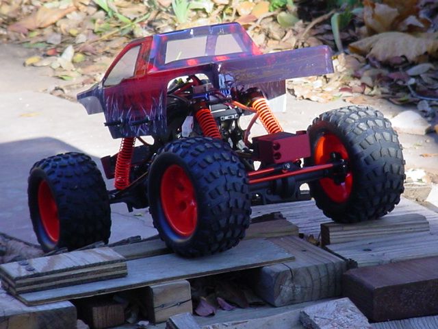

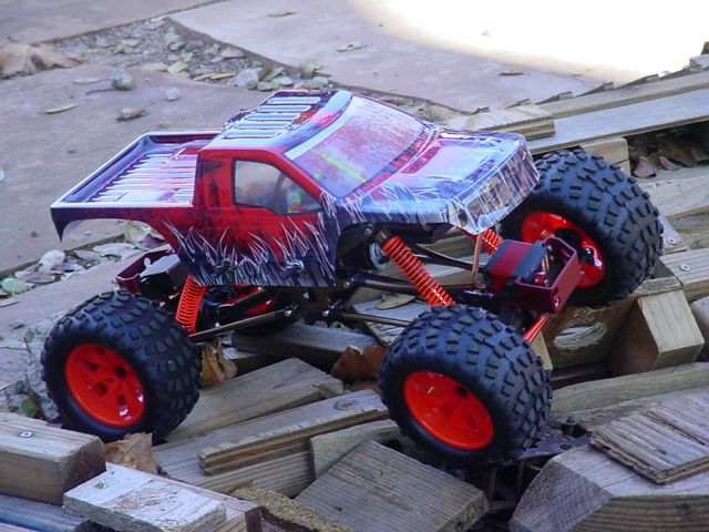

I went with rs10 radio, receiver and esc [e401]. You will also need a servo, servo plate and arm. Also the short steering link and another pair of
front suspension arms [bent for steering clearance]. A few screws and you have 4ws. Everything fits, no surgery or glueing needed.
On front steer it has a huge turning radius. 4ws is big bonus, makes a huge difference. This is one way to do it, not the only way.
