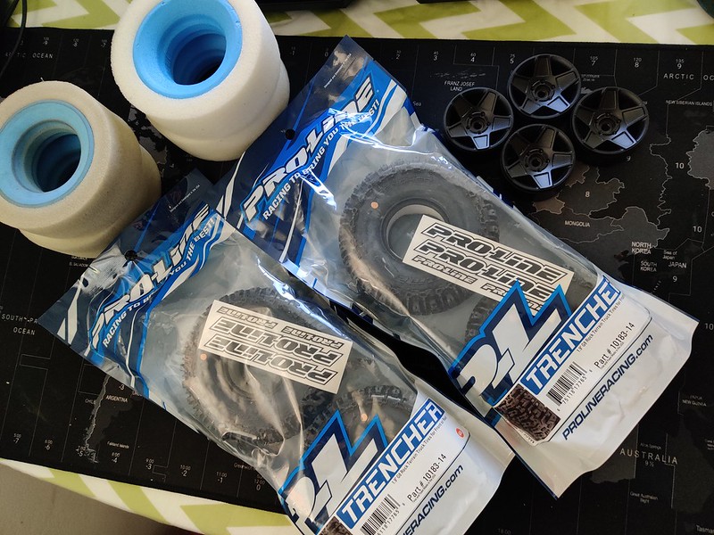

I had my eyes on the ProLine Trencher G8 tires for some time now, and this project was the perfect opportunity to try them out. So they are finally here and ready to install.
I'll be using my 1.9 Injora 5 spoke wheels with them, along with some lightly used ProLine dual stage foams.
They fit perfectly on these rims. I'm glad I went with the G8 compound, because even that feels a bit soft for the temperatures we get here.
I'm a bit concerned about the clearance at full compression but I might just get away with it. Will have to test them on the trail to know for sure. Looks pretty close, however.
