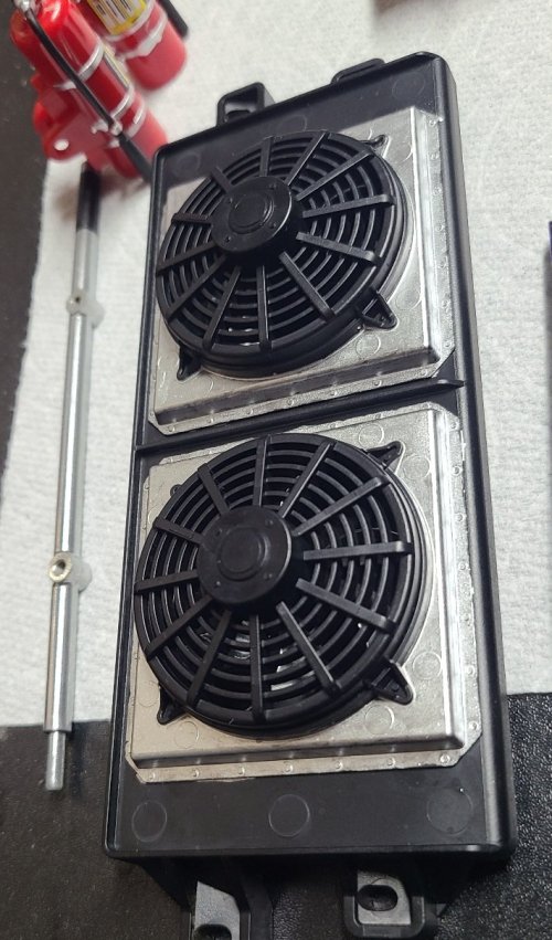

Looks great! Driving at scale speeds is just fine. If I ever get around to putting on races, FPV and scale speed + a fuzzy. MY scratch build 1 car went 45 mph, Bomber sized, and could blow through most anything and not break anything. Kinda like going to Glamis and running the sand drags all day. Hard pack at a realistic speed and a video setup is more fun. Truck is bitchen, two thumbs up. Aluminum tape on the panels is genius if you don't have a sheet metal shop. Let's be seeing some run footage. You realize that to finish this off you are going to get another set off those shocks and bypasses, Fox, in black and polished. Amazing how quickly the build price turns scale. I believe an awd Mason goes for about $1.5 m, just saying.

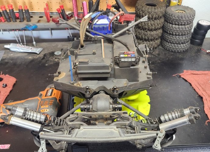

A local seller was selling the Vitavon front bulkhead and a ThreeDPrint Designs vertical tire holder. I scored both of those. The tire holder is a stiff rubber that I'm hesitant to paint. I think it bends enough that it's not realistic to expect paint to survive the flexing.
While replacing the front bulkhead I also swapped in the Savox SB2274SG Black steering servo. The faster servo should help out the gyro assisted steering at speed.
While I was replacing the front bulkhead I replaced the plastic front center driveshaft with a Hot Racing steel driveshaft. Apparently the stock plastic front driveshaft is a weak point.
