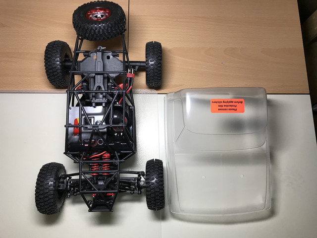

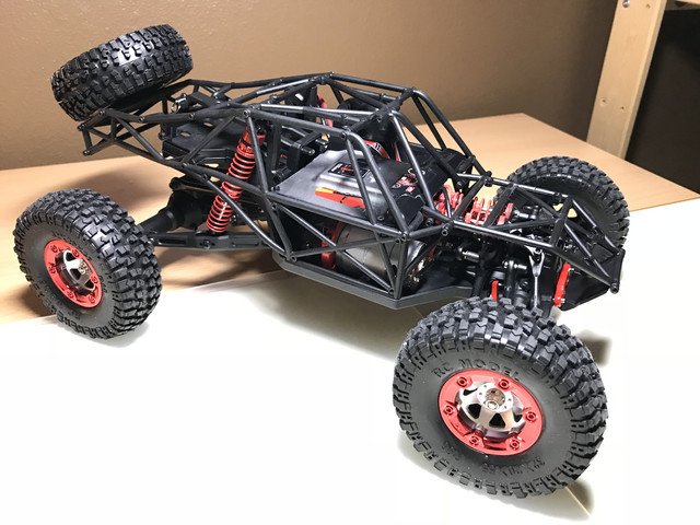

So in summary, it's a toy doing a pretty good impression of a hobby-grade car. For around $60 it's hard to be mad about it's faults. Some pictures (body panels already removed):

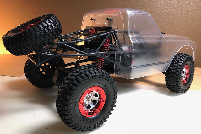

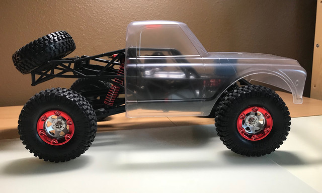

First mock-up. The cage is wayyy too low for the driver to see out. :lmao: I'll have to draw attention away from this unfortunate fact by making the windows tinted or blacked-out. Otherwise, I like it! The wheelbase looks a little short, which reminds me more of a short-course truck than a trophy truck. Next step will be fabbing up some type of body mounts. This body comes with holes already punched through the hood, so I'll probably try to make use of them.

I've seen pictures of someone that made a touring car body fit perfectly just by installing on-road wheels/tires and extending the wheelbase a bit. The wheelbase seems pretty easy to change by making new trailing arms for the rear with threaded rod.
That looks freaking awesome!!!
nice. remember where you saw those pics of the on-road body?
and yes about the links, however keeping in mind the shocks bolt up to the bottom links.
but there are tons of options. yeti. yeti XL, losi rock/baja rey, etc..."thumbsup"
cab looks okay but its a bummer the cage sits so low... hmm.

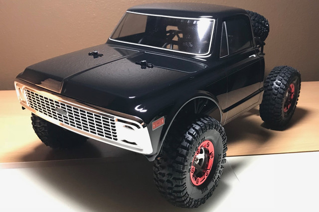

Keeping with the low-budget theme, I got creative and pieced together body mounts from the spare parts bin. Now it's mounted solid and I'm surprised how well it fits.
Meanwhile I had a spare fan I bought a long time ago (so we'll call it free :mrgreen:) that I mounted up to do something about the motor temperature. Not the most effective setup in the world but it's better than nothing. The great thing about these cheap junky cars is there's so much potential for easy improvements. It's a tinkerer's dream.
If someone else wanted to do their own take on this idea, this Proline body should fit equally as well. Heck, I may do it myself someday. The thought of having a Chevy and Ford pair of these little guys is pretty appealing, especially because you could hand the second controller to a guest.
