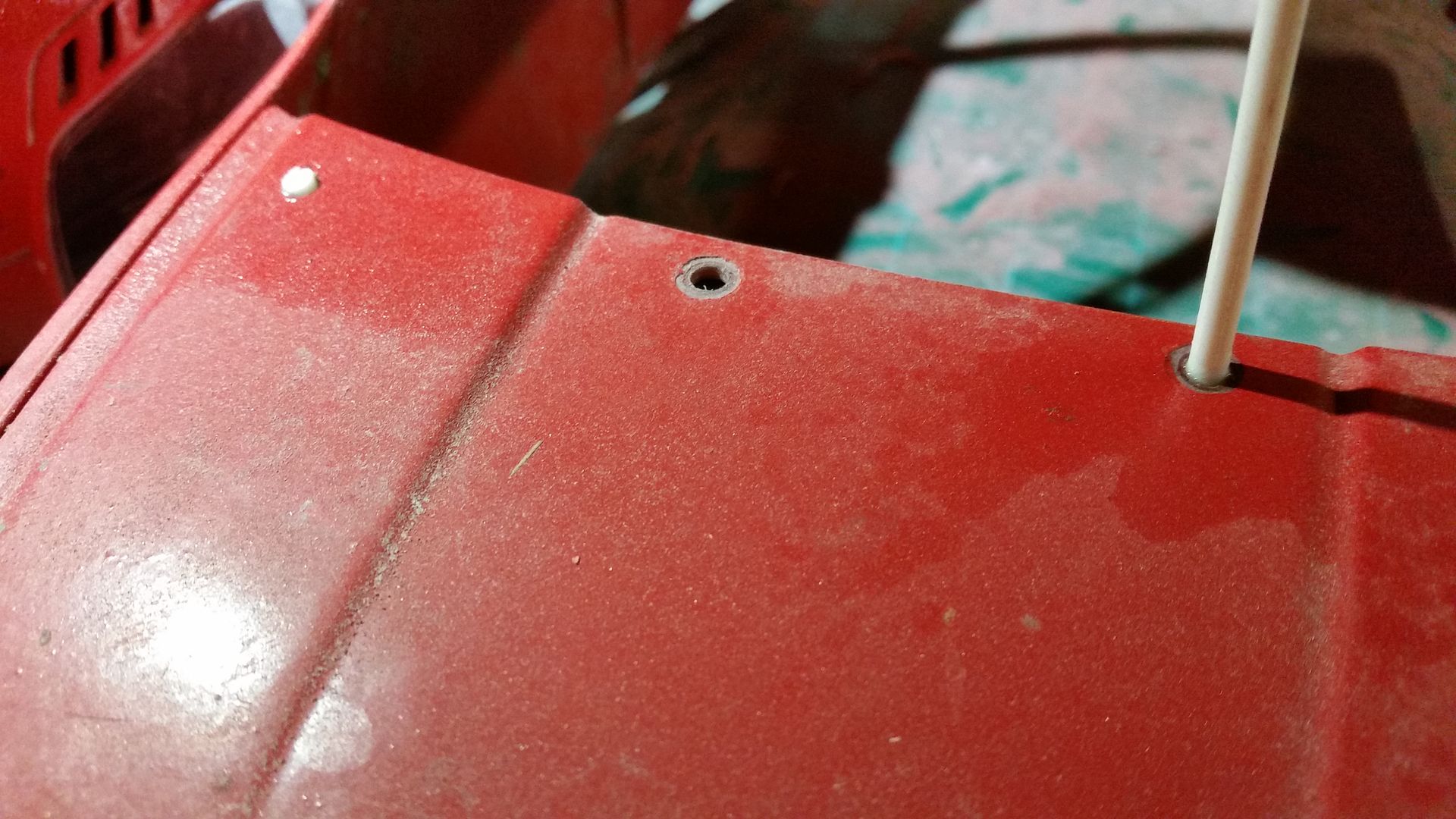

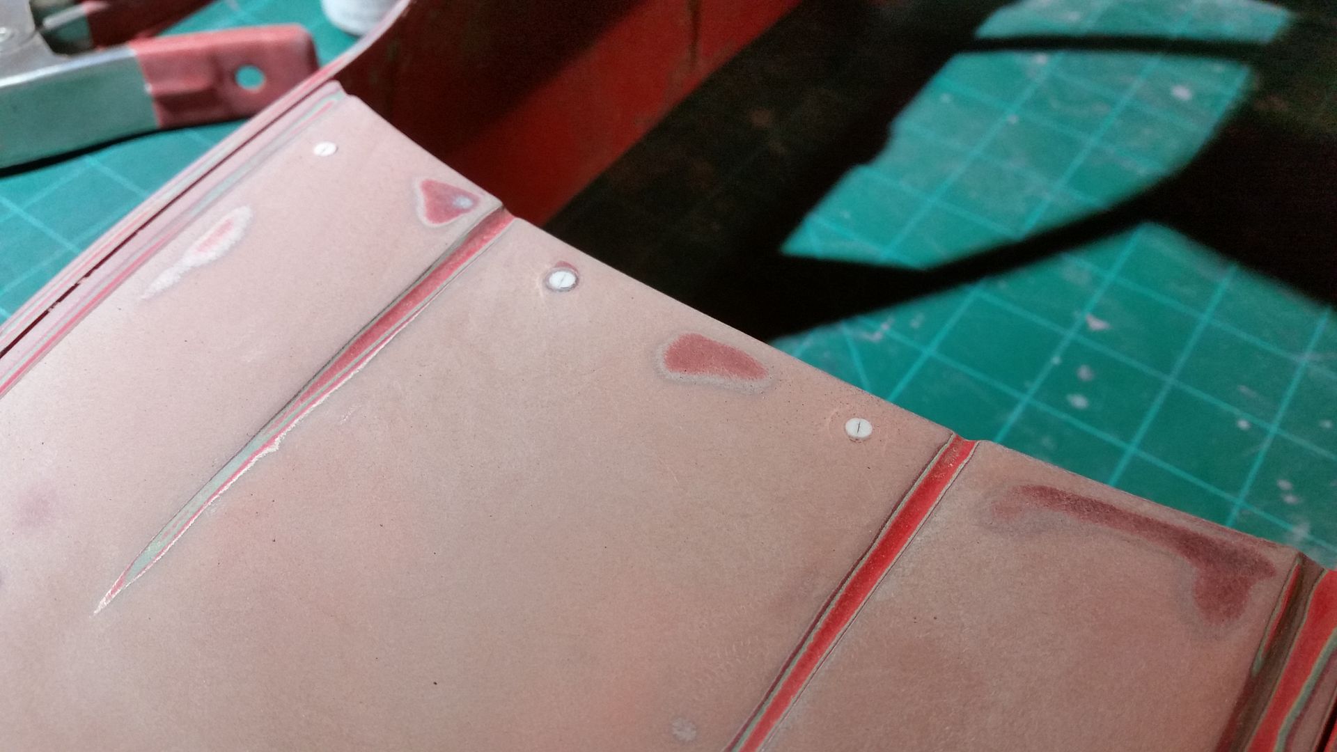

Here's how I fill holes. Drill out the holes to the size of your round styrene stock (easily found online or at nearly any hobby store). Use CA glue on the round stock and work the styrene into the newly cleaned out/drilled hole. Once the CA glue has cured you can cut the styrene off even with the surface of the body.
Once that's done you can sand down the surface until it's smooth again. You can then back the hole with another piece of scrap styrene and some CA glue or use a thin layer of ShooGoo. Don't use a thick layer as it will shrink once it has cured and may cause warpage in certain thin plastics used in a few hardbodies floating around.
