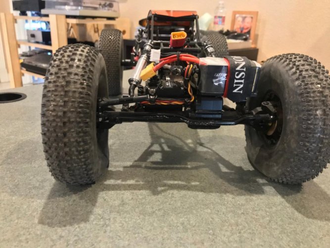

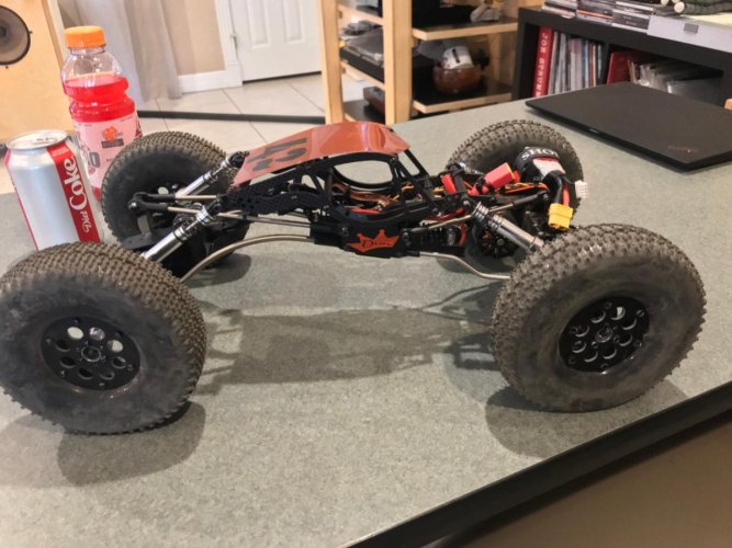

So I've been wanting to try an MOA and make a few comps with it in 2021. I've been waiting for the kits to come back in stock, and got lucky and bought one on RC4WD's one day black Friday sale recently.
The build was fun enough, certainly pretty easy, and only had a few very minor issues. Thanks to some research in advance of the build, I ordered a nice set of Avid bearings to replace all of them in the axles. Some of the hardware isn't that great, thankfully I have a ton of m3 socket caps, button heads, etc. on hand to replace with.
The tires as they come are a little stiff it seems, so I cut some pins and sanded the sidewalls a bit on the front's. I'm running narrowed Crawler Innovations 5.25 (CWR-1044) dual stage, with soft outer. I'm currently not using the tuning ring, but plan to experiment with it in the next week or so. I'm also going to mod the rear tires a bit, and put in some CI foams in them as well. I have a new set of Ibex on hand, and a set of the fantastic Dlux Fab 2.2 beadlocks. I'm waiting on some hub spacers for the fronts, and another delivery of foams from CI (5.5 softs).
I'm really enjoying the rig so far, learning to use dig, and am slowly iterating through suspension setup/tweaks.
I'll rattle off a list of parts used and a few quick pics of the rig as it is now.
RC4WD Bully II MOA Kit
Dravtech short shocks, soft in front, medium in rear, 25wt oil in them currently.
Avid rubber bearings in the axles.
Ibex, Bully comp tires, and CI foams all around.
Holmes Hobbies Snubnose Revolver's - 1400kv
Castle Mamba Micro X ESC's
Holmes Hobbies SH500V3 servo.

A few thoughts, and ramblings...
I noticed some of the RC4WD rod ends don't move as easily I would like, so I replaced them with Revo ends, 5347, 1942 (iirc), and the 5525 long ends. This helps the links move more freely throughout their range of motion.
I'm waiting on a pair of motor covers from Holmes so I don't continue to lathe down the outer cases on the rocks. I meant to order them earlier, apparently I overlooked that idea.
I took the top half of the cases off the mamba's, and I will probably de-case them further sometime soon. I would like to be able to get them squeezed into the middle of the lower skid, ideally. I suspect, however, that I may end up putting one in the center, and one on the front axle, on top of the gears. That, or I may fab a drop tray that attaches to the top of the gear case, and drops back behind it a bit. If I go that route, I'll probably try to get the receiver on there as well. We'll see what I actually come up with.

Now that I've run quite a few packs through the rig, and made a few adjustments, I'm really starting to love it. It certainly has it's flaws, and isn't perfect, but I'm enjoying it quite a bit.
I need to clock the front axle up a bit more, and I want to dial in some more caster, but I think I'll need to re-think steering if I do so. I'll experiment with that soon enough.
One thing that bugs me is the front lower link mounts at the chassis. The angle that they mount means the rod ends bind with the chassis plates pretty quickly. This binding is amplified when the rig is flexed on an obstacle.
I'm thinking I may try some bent rod ends on the lower links at the chassis. I don't want to grind down the chassis there as that would leave it very prone to break, I would think.
I'll post some pics when I try it out...
I dialed in some more caster and adjust the steering link a bit. This has improved steering, and the ability to grab on ledges, etc.
I'm going to try the bent link idea for the chassis connection point for the front lower links and see if I can improve the binding situation there.

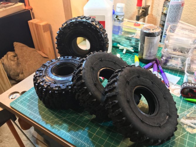

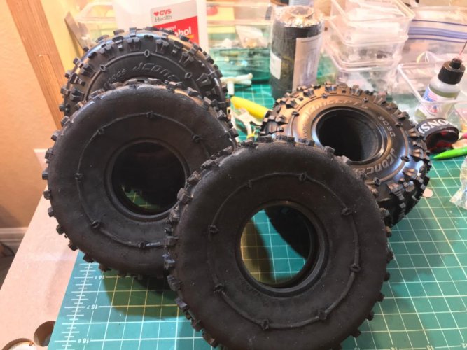

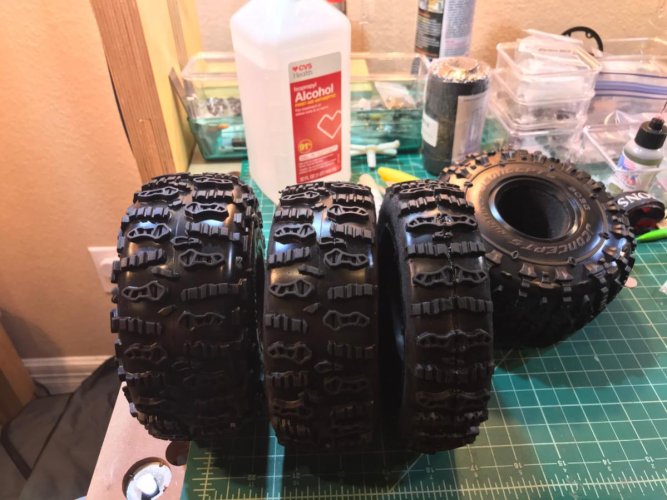

I narrowed a pair of Ibex's, and narrowed some CI 6" foams, comp cut inners, soft outers, with no tuning ring. This combo is a bit too soft and 'empty' for me. It works very well, but more foam support will help. I'm going to add the tuning rings and try that as soon as the rain goes away.
I also narrowed, cut, shaved, sanded, etc. a new pair of J Concept Ruptures. This time I shaved the sidewall ring, and the inner ribs. I put in CI foams, narrowed by me, comp cut inners, soft outers with the tuning ring. The Ruptures are a bit taller than the Ibex. I like the foam support pretty well with this combo, but may try medium outers at some point as well. I definitely like this cut/shave/etc combo better than the first pair of ruptures I mod'ed. I will likely shave the sidewall ring and inner ribs on that pair soon as well, or just run them in the rear, where a bit more support is likely a good thing.
I got a few pairs of bully pins for Christmas as well, so I'm thinking I'll do a narrow and pin cut/shave on a pair of those, to have some more options. I need to order more foams too, and wheels. I like to be able to run a few obstacles, swap the tires and run them again to compare.
I think I'll have my Dlux knuckles, shafts, etc. in the next week or so, I'm super excited about getting those setup.
Do folks tend to run narrowed tires in the rear of their 2.2p rigs, or just in the front? The steering gain with the narrowed Ibex's is awesome, and on the right rocks they seem to bite better.
Some pics of the tires. You can see where I marked one of the Ibex's to cut, I think I might cut the next set even on both 'sides', ie: cut a strip out of the center, instead of offset by one pin.
