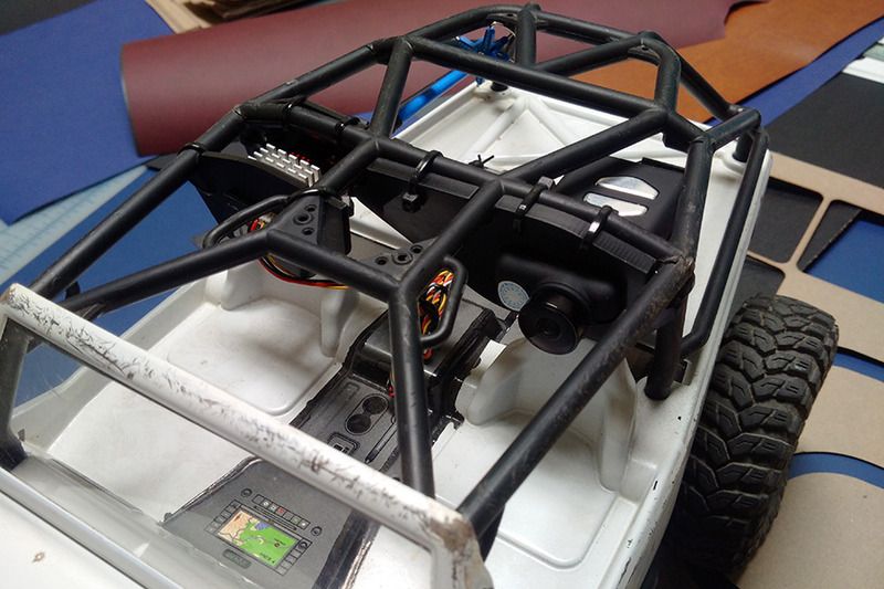

Hey guys.
I just recently got my FPV setup assembled and installed.
Here is a pic:
I purchased a Headplay headset that I'm pretty happy with.
Currently the camera is fixed, but in the near future I hope to take advantage of a head-tracking unit that I purchased and laser-cut a gimble to work with it. But that's also going to require hacking my Transmitter to have more channels, which isn't really something I'm looking forward to doing.

1. I was much happier with the immersion of having the camera inside the vehicle vs outside (sitting on hood), but I wasn't particularly happy with the limited visibility. So removing the windshield on my SCX10 helped a LOT. Having the roll-cage and dash still visible is great, because that still gives me the feeling of being inside something. I should probably install the steering wheel too...
2. I'm using the mobius camera battery to power itself (not using external power for that), but I'm running power to the video TX through my main LiPo balance leads. I was concerned that the noisy voltage supply would be an issue (since my main LiPo also powers my entire RC car), but that issue is very minimal for my setup. I only notice a very minor improvement in video quality (at nearly the video-range limits) from backing off the motor-power... so a seporate video TX battery, or a power filter from the main battery isn't really something I am looking into any more.
3. The antenna can be quite directional when pushing the range-limits. My antenna is pointing directly backwards (see photo in first post). Ideally you would want the antenna pointing straight-up, but there's no good way to do that and still protect it. I've crawled through a lot of holes, bush-wacked, and rolled enough times already in my 2 outings that I know I made the right choice to keep the antenna inside the cage, and pointed backwards.
