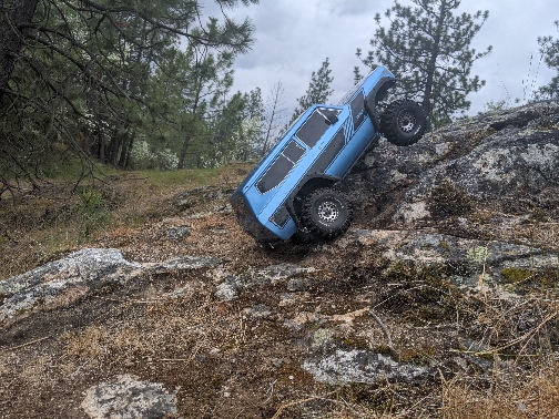

Does it really need brass? I have found it to be very capable just with chanquish wheels, deep woods tires and proline dual stage foams. The drivetrain under that is Axe platform.
